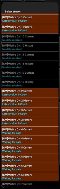

I went into the app and added the custom PIDs, which are all listed under "[GM]xxx"
I am getting no misfires, at idle, according to this, but still able to feel a slight shaking.

Another thing you will find is that torque is somewhat a "community app"... meaning that it is not "sanctioned" by the auto makers and thus not everything is guaranteed to be "spec'ed as engineered"... meaning not all information presented is exactly as the auto maker designed, GM in this case. The values that you may see are not "raw data" but are usually the result of some "formulation" which in lots of case, have been "reverse engineered" by some "net member" and added to files or presented for people to add to torque.
Based on the values that you show, it would appear that there are no misfires happening, which is good. But I am not sure what you mean by "slight shaking driving around"... rough roads! ... :-)

1. Based on the values that you show, it would appear that there are no misfires happening, which is good.
I ran some logging and show only 2 misfires in cyl 4 over about 10 minutes of idle, 1500rpm and 2500rpm logging.
