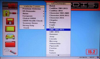

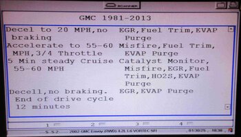

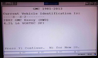

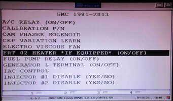

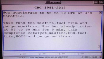

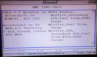

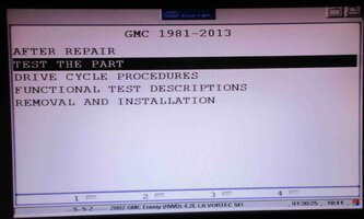

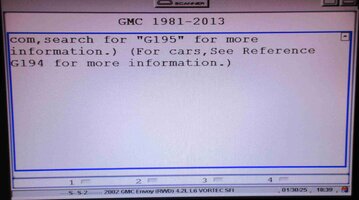

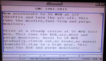

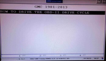

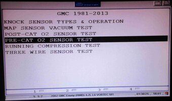

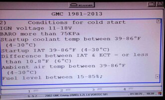

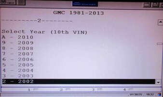

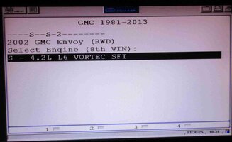

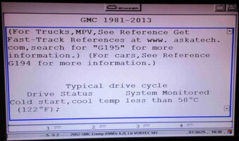

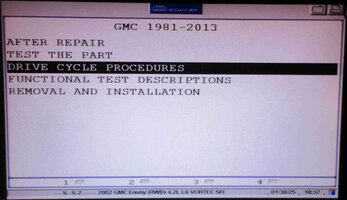

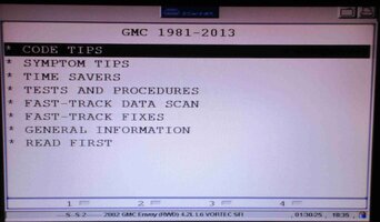

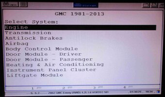

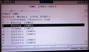

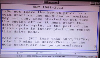

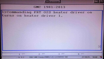

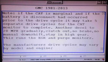

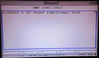

FWIW... Here are the... OEM Drive Cycle Procedures Specific to YOUR Vehicle ...as presented in the Snap-On Modis Diagnostic Scan Tool... Professional Instructions. YMMV with variations in Pro-Grade Scan Tools... but THIS information is generally nested within your GMC 2002 Envoy Service Shop Manual...which may be MORE complete. Refer to Yours after downloading it from THIS Link:
The First (20) of (25) Screen Captures:
IMG_1477.jpgIMG_1478.JPGIMG_1480.JPGIMG_1481.JPGIMG_1482.JPGIMG_1483.JPGIMG_1484.JPGIMG_1485.JPGIMG_1486.JPGIMG_1487.JPGIMG_1489.JPGIMG_1490.JPGIMG_1491.JPGIMG_1492.JPGIMG_1493.JPGIMG_1494.JPGIMG_1495.JPGIMG_1496.JPGIMG_1497.JPGIMG_1498.JPG
The Last (5) of the (2) Screen Captures follow...
Reactions: Wano and christo829
Last (5) of the (2) Screen Captures :
Reactions: Wano
