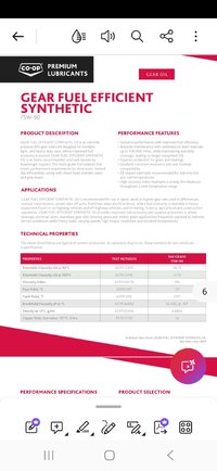

I worked on my daughter's 2020 Ram 1500 classic today. Bought used with 85,000km. I did the full break down and inspection. It went way, way, WAY better than our other 1500. Everything came apart easily, everything had antiseize applied, the slide pins lubed, differentials serviced and brakes bled.
The cv shafts easily popped out from the hub splines, even with noticeable rust. The tripots came off the stub shafts remarkably well. I know the dealer had replaced some parts prior but I was surprised to see antiseize had been used. Regardless, more was added and it was all buttoned up.
I realized I was out of ATF, so the transfer case will wait. I will likely pick up a pail of PetroCan Duradrive LV to start some drain and fills on the ZF 8 speed.
