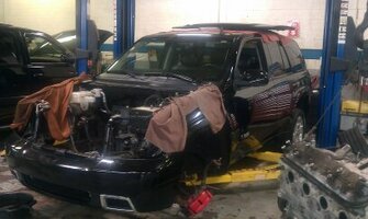

I know I'm a little late to this thread, but mine spun at 32k. Took the dealer a month to find a motor.
ouch!!! they messed with your whole suspension... i guess it is easier to lift the body off the frame :rotfl:
