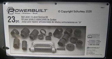

Things go way easier if you hit up the "Loaner Tool" section of your local parts store, and borrow the ball-joint press kit.
I liked it so much, that I told them to keep my money--I'd just buy the thing.

I did use a press to install but my “little kit” didn’t have the cup that goes on the narrow ears for the lower. The 3lb hammer was actually really easy and effective (with an old 3/4” socket as a punch).
I also learned to apply just a bit of silicone spray at the interface which made a huge difference, both in getting the old one out and the new one pressed in.
I fought the press a lot on the first LBJ but the second was fully in within just 5 minutes between a few iterations of press with impact then large hammer.
I also lubricated the press itself with the silicone spray. No use in wasting that impact energy on friction!

Any lube is better than no lube--but a high-pressure moly-based grease would be better on the pressure screw of the BJ press.
