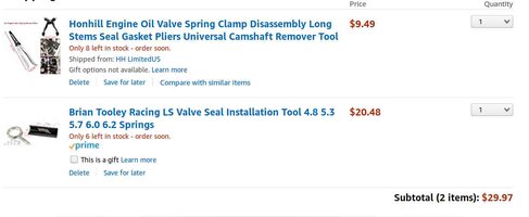

As mentioned… I had to pick up just a few more “Specialty Tools” that are strictly meant to help R&R those Damned PITA Valve Stem Seals that can either:
(1) Scratch and Damage the Smooth, Hardened Surfaces of Each Valve Stem during the Seal Removal-Replace events ...using the Wrong Tools.
(2) Damage the Delicate Spring-Tension Viton Inner Seal constructs during the Installation of the New Valve Stem Seals ...using the Wrong Tools.
For the Modest Cost and the HUGE Benefits of using these One Off Tools… It’s just not worth the time and effort to go Rummaging around inside of your Dirty Tool Boxes looking for and finding the Wrong Tools to take these necessary R&R Steps when trying to do these kinds of Jobs...Right.
For Example… Watch BTR’s (Brian Tooley Racing) Big Boss Man Himself in this Video (in the latter part) showing how the easily his "NEW" BTR - LS Valve Stem Seal Tool Kit makes this Valve Stem Seal Installation go PERFECTLY SMOOTH... (16) Times in a Row... and REMEMBER his Wise Advice... "HIDE THE HAMMER FROM YOURSELF..." :
The Three Quality Main Players for this LS6 Beehive Valve Spring Swap necessary to handle the .550"/.550" Lift are below. The BH Springs will be coming from Texas Speed and Performance... The Keepers and Locks ... from CompCam. I'm also suggesting here that you probably COULD use the "Stock-As-Clock" Keepers and Locks... But.. Why Look For Any Trouble with ALL the Bread You'll already be investing into Beefing Up Your LS Motor's Performance?

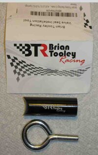

Okay... The Brian Tooley Racing LS Valve Stem Seal Installation Tool Kit Arrived. It does not disappoint in the design and quality evident that he puts into his stuff...and in fact this is a Damned Clever and Elegant Solution to the problem of having to install those (16) Valve Stem Seals with a very minimal chance of unseating the 3 Angle contact surface of the Valves and having them fall down inside of the Cylinders.
This of course would only apply if one chooses the Compressed Air solution of pumping in around 50 PSI into each Cylinder versus using my preferred Method of confirming that Each Piston is right at TDC so if any of the Valves DO Drop ...they will only travel downwards about 1/8".
If that occurs, they can easily be coaxed back up using a Curved Pick after compressing the Beehive Valve Springs down enough to be able to drop in at least one of the two Keeper Lock Halves and securely grip the groove at the top of each Valve Stem. Then its just a matter of sneaking in the other half to Lock the Retainer securely at a (7) Degree Angle to the Valve Stem. This Kit cost right at around Twenty Bucks... and is well worth using instead of my having to experiment with any other Clunky or Risky Method that might damage these delicate, coil spring contained PTFE Seals:
BTRLSVALVESTEMSEALTOOL0.jpgBTRLSVALVESTEMSEALTOOL2.jpgBTRLSVALVESTEMSEALTOOL3.jpgBTRLSVALVESTEMSEALTOOL5.jpgBTRLSVALVESTEMSEALTOOL7.jpgBTRLSVALVESTEMSEALTOOL8.jpgBTRLSVALVESTEMSEALTOOL4.jpgBTRLSVALVESTEMSEALTOOL10.jpg
