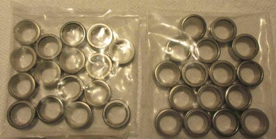

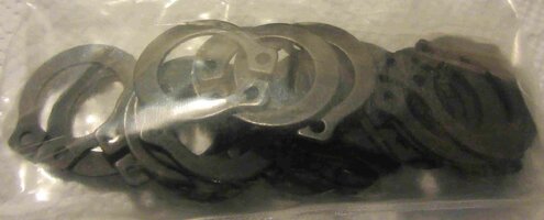

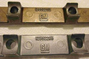

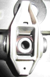

Never having had a GM LS V8 Engine with a Valve Train and Rocker Arm Assembly that are both accessible and serviceable with equal ease… I determined that they also lend themselves to being greatly upgraded with a simple, $100 Trunnion and Caged Needle Bearing Kit to improve what is probably the only serious Achilles Heel laying in wait up inside the Top End of these Engines. Each one of these OEM Rocker Arms contains 33 Unrestrained Needle bearings that can wreak havoc if allowed to come apart at any RPM and become distributed throughout the interior of these engines. But… Anybody with a “Bean” and a Bench Vise or a Small Arbor Press from HF and armed with some Common Sense can completely eliminate this very real threat in very short order and forever with a Kit that will ensure smooth Rocker Arm Action ...all the way up to 1,000 Horse Power:
… This is What the Kit Looks Like:
… This is Where to get it:
https://www.amazon.com/dp/B075X5PQHN/?tag=gmtnation-20
… This is a Comparison with the OEM Version on How to Rebuild them with an AMK covering the CompCam Kit from Summit:

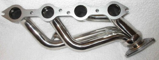

Last but not least are… The Shorty Headers:
I keep seeing the Stainless Steel versions that run between $100-$200 on Amazon and eBay with varying looks and quality and some sketchy incompletion of the TIG Welding on many. When I can find one that has Quality S/S with Thick Head Flanges and completely circumferential Welds around the Primary Tubes… THAT will be the one I buy. But… I’m not interested in paying $450.00 for these Pipes… so only a Happy Compromise in the Price Range vs. Quality will make it happen.
I dunno if the self destruction of those rocker bearings is blown out of proportions because only people that have had problems with them, mostly those that modify their engines, talk about it, which would make it sound like they are failure prone. We don't hear from those that have run their vehicles for +200k miles without a single issue with them. However, thanks for pointing me to those on Amazon. I can get them from Amazon.ca at a comparable cost delivered to my door. This will be useful for my L77 '11 Caprice PPV that I do plan on camming.
I have heard that Comp. Cams' version is garbage if you happen to come across it. And I'd also be weary of those that use bronze bushings as they will wear down over time. I like the idea of captured bearings. I can't seem to find a lot of reviews on them though.
You're Welcome, @Mooseman... Anytime... Ordinarily, I wouldn't pull a hair with worrying about the Needle Bearings coming loose in those OEM Roller Rocker Trunnions... but they do look to have a weakness. Being as superstitious as I am about Engine Mods and knowing that I could've easily performed this R&R at the same time I'm replacing those Old LS1-LM7 Valve Springs with the New "LS6 OEM Style" Quality Valve Springs that comes with the Melling CS-MTC-8 Performance Camshaft Kit... I'd be kicking myself in (6) Months for not doing so when I had the chance if anything were to 'head' sideways in the Top End. I realize that my (18) Year Old Truck does have "Youthful Mileage" at only 72,654 Miles... but why Tempt The Fates? Besides that... Right Now...The Price is Right.
Just as an added FYI... Both Summit and Powerhouse Tools do sell Specialty Trunnion R&R Tool Kits that run between $36 and $50 ... and if it means making this transition much easier and whole lot more orderly with so many parts and pieces to pay attention to during these R&R procedures, it just might be worth the $$$. Have a look at how Cool this Powerhouse Tools LS Rocker Arm Trunnion Tool 54702-TL works:

I'm not saying that they never cause problems but, I have 20 vehicles with a 6.0 engine and I've never had a single problem with a rocker arm. The mileage on these engines range from 60,000 miles to 250,000 miles. Most have 150,000+
The higher mileage ones have been starting to throw a random misfire code. I found that if check the misfire counters and then change the valve springs on the higher numbered ones and then do a cam/crank relearn, the problem goes away. If I was doing the work for someone I would change all of the springs but, it is fleet work and the higher mileage vehicles probably won't be around much longer.
Enjoy your truck!

The 2500HD has been treated as an on off switch for the last 210k. No problems to report yet. I do understand the worry though.
Of course... There doesn't seem to be very much in the way of empirical evidence to support my desire to just apply this repair... but my roots as a Military Mechanic and SAR Crewman go way back to 1970-1974 while being an Aviation Machinist's Mate in the USCG. On one scary occasion... I was having to write up a "UR" (Unsatisfactory Report) while inspecting the Five Blade Tail Rotor of one of our four Sikorsky HH3F Helicopters. While performing some 25-50 Hour Scheduled Maintenance on the Tail Rotor Spindle Turnbuckle Bearings-To- inserts measurements of this Bird... and even though it was Safety Wired in place... I was able to pull it completely free from its socket of one of the Blades. So I learned very early on with experiences like this ...to always Look Deeper and thereby... NOT suffer from any Failures of Imagination.
Consider it this way... At an idle of just 600 RPM... each Roller-Rocker in the LS Engine is actuating up and down at a rate of 5 Times Per Second. But at 6,000 RPM ... that translates to being 50 Times Per Second for each of the (16) Roller- Rockers with Grand Total of (1,056) Un-Captured Needle Bearings nested inside of all (16) Roller-Rockers...with a Known History of Failure in GM's OEM Trunnion Design. So if doing this Trunnion R&R completely eliminates this problem.. .AND ... perhaps even gives more rotational stability to the Valve Train via Smoothly Turning Roller-Rocker Arms... Then I'm good with that idea.
Oh... and about that 'Dearth of Evidence' on this subject... Check out what happened to THIS young man... who mentioned very early on his Multi-Part 500 HP "Budget" LS Engine Building Series... "I was thinking about replacing the Rocker Arm Trunnions using an Upgrade Kit... but right now I'm spending the Money on other parts...":.. Watch what happened to HIM. In the First Film...Speed Dial to 7:10 for the, "THIS CAN'T BE HAPPENING...!" In the Second Film... around 4:20 for the, "OH YES... IT CAN HAPPEN"...and in the Third Film it shows from their struggles and the amount of time they had to spend on the Trunnion Kit Upgrade as to WHY Using THE REAL Trunnion Tool is a Very Good Idea for doing this R&R:

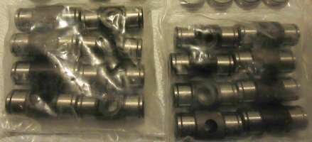

I've finally decided to “Stop Moping… or Hoping for Loping”...and begin acquiring what I will need to actually accomplish this project before it comes time for me to Take A Dirt Nap. I think I've found a Better Deal on the LS Engine Full Trunnion Bearing Upgrade Kit than the one mentioned previously in this link below:
I checked around on eBay and found a Vendor that has sold almost 800 of these Trunnion Upgrade Kits for around $90.00 with Free S&H. I also I note that this Kit from "ZZPerformance" has the New, Larger Spring Steel Retaining Clips Upgrade that should prove sturdier and more to the liking of their Customers. I just became one of them… and while ordering the Kit… I also purchased the last available low cost LS Engine Push Rod Kit made by Elgin from "classicenginesupply" as well.
This what I picked up instead… from eBay:

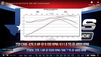

#1 on the Runway next will probably be looking closely at the Texas Speed Stage 2 Low Lift 212/218, .550"/.550" 112 LSA Camshaft Kit that will … L^^o^^^p^^e along... Just Enough … without demanding any change to a Higher Stall Torque Converter and have a set up that will be interesting to drive and listen to… and still have the Motor behave itself on the Street.
https://www.michiganmotorsports.com...shaft-kit-includes-spring-set-and-gasket-kit/
This is how the Cam performs on the Dyno (Modified Intake and Headers NOT installed on my LS):

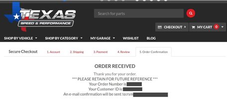

Originally, I was going to also go with a TSP cam - 212/218, .550 lift, 114 LSA. I've since decided to go with a Comp 'XFI Xtreme Truck' model (206/212 @ 50 .513..520 lift 115 lsa with +4 advance). Springs will be the GM LS6 'blues', just like you're doing. Those are good to .550
Before I order the cam, however, I'm going to remove the old one. Why? Because I have a sneaking suspicion that it may have been 'upgraded', already. Just a hunch, based on the difference in 'feel' between my old Sierra and this one.
When I contacted TSP, they advised that a tune was going to be required - so don't be surprised if you have to go the same route.

Yes, I'm going to install a trunnion kit - as @Mounce 's photo shows, the bearings can be an issue even in a stock motor. Brian Tooley Racing has a nice video on YT on how to replace them, and it turns out his pricing is pretty aggressive, too - so I may go with his offering.

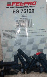

Bolts will be ARP - yeah, they're a little pricey, compared to the OEM, but I expect to be able to avoid 'torque + degree' tightening on both the head & crank bolts. They're also reusable, should I ever need to go in again.

As for headers...I've been considering the 'shorty' ones, too - but supposedly, they don't improve things that much over the stock manifolds. Found out a few weeks ago that due to GVWR of my truck, that it's exempt from emissions testing. That opens up a lot of other possibilities for me (although I still want to use cats). For now, I'm going to keep things 'as-is' WRT exhaust, and re-evaluate once I get everything done.

$150.00 OBO DPT Shorty Exhaust Manifold Header Stainless (Supposedly) Fits the 99-05 Chevy GMC Silverado Sierra:
http://rover.ebay.com/rover/1/711-5...0001&campid=5338077216&icep_item=110918041506
However… In Spite of having the Required EGR Port… AND Meeting THESE parameters… when checking the Year-Make-Model… eBay Red Texts the Comment… and so it raises the Most Important Question:
WILL THESE HEADERS BOLT ON MY Y2K SILVERADO 5.3L ENGINE... AND WORK PROPERLY?

I think I just found the One and Only CORRECT (inexpensive, too) S/S Shortie Header Set that WILL Work on the Y2K Truck:
SHORTYSTAINLESS2.jpgSHORTYSTAINLESS3.jpgSHORTYSTAINLESS4.jpgSHORTYSTAINLESS6.jpgSHORTYSTAINLESS1.jpgSHORTYSTAINLESS5.jpg

Okay... Yesterday afternoon... The Trunnion Upgrade Kit arrived with VERY FAST FREE S&H... and the Shipped Parts Tally is COMPLETE and as Follows:
(16) Fully Encased "Trapped" Needle Style Roller-Bearings.
(16) Roller Bearing "Full Barrel" Trunnion Axles with Proper Center Rack Mount OEM Design.
(16) 'Grade 8' Blued Steel, Hex-Wrench Style Roller-Rocker Arm Bolts.
(16) HUGE (FAT) Blued Spring-Steel Retainer Trunnion Locking Rings.
(2) Two LARGE Assembly Washers for use during "General Assembly".
Plus.... Wait For It....
One Complete Set of Everything Mentioned Above as a Back-Up--> FREE in the Kit.
Now I'm just waiting for the Set of (16) Old Roller Rockers from my eBay purchase AND The CompCam Roller-Rocker Arm Trunnion Rebuild Tool via Amazon to arrive, so I can clean them all up in a "Berryman's B-12 Bath"... Dry them off and after wiping them all down, while I'm perfectly at my leisure... I'll assemble all of this inexpensive "Peace of Mind" using everything listed above... plus a Small Carpenter's Vise ...while I'm sitting on my couch watching TV. :>)
Bit By Bit... We'll 'Get 'er Dunn...'
By the Way... All of this Stuff collected together is Well-Made and suprisingly HEAVY as Hell! Here is what this Gear looks like while still inside of the "Protective, Oily Plastic Bags":
ROLLERROCKERUPGRADES1.jpegROLLERROCKERUPGRADES2.jpegROLLERROCKERUPGRADES4.jpegROLLERROCKERUPGRADES5.jpegROLLERROCKERUPGRADES6.jpegROLLERROCKERUPGRADES7.jpegROLLERROCKERUPGRADES8.jpegROLLERROCKERUPGRADES9.jpegROLLERROCKERUPGRADES3.jpegROLLERROCKERUPGRADES10.jpeg
What??? That doesn't make any sense. You think it might be a packing error instead?
Nope... The other Items were all discreetly packed within their own groups... that Last Kit contained One of Each Item (except for the Two Assembly Washers) ...and this 'One of Each Lot' arrived sealed up inside One, Smaller Plastic Bag. So apparently... they intended upon including one additiona item of everything that would be critical for completion of the R&R and I suspect ,just in case of ANY Loss or Damage by the Customer(s) to any one of these Items during assembly. In any case... It seems like a generous as well as a practical consideration from a business perspective... Don't You Think?
Oh so it's basically parts for ONE rocker rather than 16. Is there a country of origin? Ebay listing doesn't say.
Yes... One Complete Set of Parts for One Roller Rocker Arm. Regardless of their point of origin... there seem to be ample artifacts indicating quality and care in Manufacture as these Roller Bearing Needle casements are stamped with some complex name/number on the edges and they all appear to be made of either Stainless or Nickel Chromium Steel. Each is fitted with a clear plastic oil retainer to protect the needle bearings within prior to installation. Also... all of the Trunnions are very finely finished and painted and bear no manufacturing defects, cracks or unsmooth edges of their margins, either.
It seems entirely possible that these could have an overseas origin... but there also appears to have been 800 satisfied eBay Customers (plus my order) which would indicate at least a high average in Customer Satisfaction. This is like anything else... when trying to make a comparison to things manufactured in Canada or the USA... most of the time things will be of much better quality if made here. But my main reasons for doing this have been completely satisfied ...merely due to this product's improved design over the Stock GM OEM Components that have been problematic enough to fail... and God Knows that they were either made in Mexico...or Made in China... however infrequently the case for failure may be. Having those Damned Fine Needle Polished Steel Bearings completely encased and trapped inside of THESE Trunnion Sets gives me more Peace of Mind about using them instead.
Also... based upon prior Customer feed back... the ZZPerformance Company decided on their own to respond to requests for Product Improvement by INCREASING THE SIZE OF THE BLUE SPRING STEEL Retention Clips that hold the Trunnion Barrels in stasis on either side of the Roller Rocker Arms. Judging by comparison with those similar but smaller Spring Steel Clips made by the Stateside Michigan Company from the other eBay offer for this similar Trunnion Kit... I really much prefer this version as a serious upgrade.
So far... All of the high water Marks have been met by what they sell... and I cannot wait to continue with assembling all of this stuff into and onto the GM OEM Roller Rocker Arms and show some more images of what these look like when their builds are completed. I will be using Permatex "Ultra-Slick" Engine Assembly Lube to pre-lube the Needle Bearings and the Trunnion Barrels to give them there Baptism in Lubricant prior to installing these all on the LM7 Engine Heads and cranking over the engine after the Performance Camshaft installation is complete.

Okay... All of the "Old LS Trunnions & Push Rods" Gear arrived this afternoon, so I dug out a Brand New Container of Berryman Chem-Dip and after snapping the images attached below... I dropped all of the Trunnions and OEM Fasteners down inside of the in-dwelling Plastic Basket. They will have a "Nice Leisurely Soaking" for around 48 Hours, as these all look like they are the Fossilized Coprolites of a Stegosaurus... Dangerously Dirty ...and definitely in need of a Good, Long Chemical Wash.
Friday Morning on May 24th, 2019, I'll lift out the Basket and then search around down inside the Dark Depths of the Noxious Chem-Dip Bucket with a Strong Telescoping Neodymium Magnet for the complete collection of all these Roller Rocker Components.
Afterwards, they'll all need a secondary washing down with Hot Water and then Dried via a Heat Gun to keep them all from Rusting Up. I'll Set Up a Small, Sanitary Work Space and Follow the Instructions in the CompCam Video for the Use of the Specialty Trunnion Tool and Use the PDFs as the 'R&R Trunnion Build Bible'. Of course... I'll memorialize everything in Digital Images and Post the End Results here.
I decided to get a Craftsman Model 37907 Dual Cir-clip Pliers Set that can handle Inside and Outside Cir-clip and Spring Steel Locking Rings, even though I'm pretty sure I have an Old Set out in the Garage somewhere. These have been rated pretty high for what they are meant to do via Amazon Customers who made the mistake of buying the CHEAP Versions and suffered when they bent and gave way during various Cir-clip R&Rs.
There is NOTHING worse than having to Buy and Use a Specialty Tool that simply Does NOT Work. You can imagine from prior experiences of having to also spend way too much time either failing to get the Cir-clips installed properly... or having them spring loose and fly all around into hidden and unrecoverable locations, just when you're finishing up the Trunnion Assembly as the Last Thing to do B4 they're ready for Installation back on the Engine Heads. This the Link to the Amazon Offer on this Craftsman Dual Cir-clip Pliers Set:
CHEMDIPTRUNNIONS1.jpegCHEMDIPTRUNNIONS2.jpegCHEMDIPTRUNNIONS4.jpegCHEMDIPTRUNNIONS5.jpegCHEMDIPTRUNNIONS6.jpegCHEMDIPTRUNNIONS7.jpegCHEMDIPTRUNNIONS8.jpegCHEMDIPTRUNNIONS10.jpegCHEMDIPTRUNNIONS11.jpegCHEMDIPTRUNNIONS12.jpegCHEMDIPTRUNNIONS14.jpegCHEMDIPTRUNNIONS15.jpegCHEMDIPTRUNNIONS3.jpegCHEMDIPTRUNNIONS9.jpegCRAFTSMANCIRCLIPLIERS1.jpegCRAFTSMANCIRCLIPLIERS2.jpeg
Okay… This is IMPORTANT because these Issues are NOT covered within the Instructional PDFs:
Here is a Cautionary Run Down of the Processes for Cleaning, Prepping and Final Assembly of the ZZPerformance Roller Rocker Trunnion Upgrade Kit Installation Procedures:
(1) “Dunk’em In Gunk'em” or in this case… Drop them into the Berryman ChemDip for 48 Hours.
(2) Get a wide mouth Plastic Peanut Butter Jar & fill it ½ way up with VERY HOT Tap Water.
(3) Pull out 4 Roller Rockers at a time and drop them into the Plastic Jar and Cap it TIGHTLY.
(4) Gently Shake the Plastic Container to dissolve the ChemDip Residue from these motions.
(5) Drain the Container in the Sink and use Blue Scott Shop Towels to Tap the Roller Rockers against the Towel and Dry them off completely. Do this several times and they will “Come Clean”.
(6) Set up the 4” Vise to accept the Trunnion Tool and Mount the Magnetic Base onto the Rigid Side.
(7) Set the Trunnion into the Matching Concave Slots inside of the Tool and guide the wide end of the Push Pin over the outer edges of the Outer Bearing Housing.
(8) This will take a bit of juggling to adjust everything in alignment as you Slowly Snug the Vise Arm inwards.
(9) Once the components inside the Vise are aligned, Use a Box End Wrench as a Lever to slowly turn the Vise Handle and squeeze down on the components in between.
(10) This sensation should feel like you are “Arm Wrestling ...and Winning”… but if the inward motion suddenly STOPS… YOU SHOULD STOP, TOO!
(11) If this happens...Unwind the Vise and Re-Align everything again; ensuring that the Roller Rocker Housing is Definitely sitting correctly inside of the Concave Trunnion Tool Base.
(12) Tighten for around 3-4 Complete Turns of the Vise Handle until the ENTIRE Bearing assembly suddenly lets go with a slight “Pop!”…. And STOP TURNING!
(14) SLIGHTLY Unwind the Vise handle and lift up everything while cupping your fingers around all of the loose components.
(15) LIFT EVERYTHING UP and TO THE RIGHT AND UPWARDS… or the Loose Bearing Housing, Inner Race & Tiny Needle Bearings will Tumble OUT all over Hell and Gone!
(16) Hold everything in your hands until you can position them over a wide mouth Plastic Bucket.
(17) Then… Release everything by Tilting the items towards the Left and Downwards as the Needle Bearing Cases come apart and the Needle Bearings and Inner Race fall out loosely into the Bucket.
(18) Follow (1) through (17) And ... Wash… Rinse …Repeat (15) More times to obtain (16) Empty, Cleaned Up Roller Rocker Arm “Cages”.
(19) From Here on Out... Follow the Trunnion Bearing INSTALL Instructions covered in the above PDFs for the careful re-construction of the Completely Re-Built Roller Rockers. The attached images should also be very helpful.
(20) Remember... When using the Spring Clip Pliers for SPREADING the two ends wider… Keep the Tool AND the Spring Clip right over the ends of the Trunnion Bearing Barrels and MAKE SURE THE TOOL LOCKING SCREW IS SNUGGED UP TIGHT or it will become skewed and twist the Spring Clip out of Alignment.
(21) Double Check that the Blued Steel Spring Clips can Spin Freely and Independently inside BOTH Ends of the Trunnion Bearing Barrels Grooves as it is VERY Easy to MISS THE GROOVE ENTIRELY. If the Snap Ring will NOT Rotate… Re-apply the Spring Clip Pliers and DO IT ALL OVER AGAIN ...UNTIL YOU GET IT RIGHT!

Early this morning after thinking a bit... I finally decided to jump sideways, task-wise and Order the Y2K Silverado Stainless Steel Short Headers via Amazon as these were fairly inexpensive and just about as Difficult to single out from a bewildering array of similar type and style of Header Set as it is to try and 'Separate Fly Sh*T... From Pepper'. I may wait until after the work on whatever Performance Camshaft Kit I decide upon getting is completed before installing these Headers. At the very least ... I'll have them here on hand when the time comes to install them:
SILVERADOHEADERS1.jpgY2KSILVERADOHEADERS3.jpgY2KSILVERADOHEADERS4.jpgY2KSILVERADOHEADERS5.jpgY2KSILVERADOHEADERS6.jpgY2KSILVERADOHEADERS2.jpgY2KSILVERADOHEADERS1.jpg
I note here that I've been planning for quite a while now on Performing a Complete A/C System Swap. Last Year... I ordered and received the Delphi A/C Compressor, the ACDelco Condenser Coil , the ACDelco Accumulator and the Orifice Tube & PAG Oil. So I figure that might as well perform ALL of this work at the Same Time... before it gets impossibly "Florida Hot" this summer to drive around on "Hot Dark Gray" Leather Seats. With the removal of the Front Grill, the Radiator, the A/C Condenser Coil and the Plastic Fender Well Liners... that should give me an uncommon amount of open access for ALL Three of these Projects.
Doing it this way exposes additional access area to the R&R of the A/C Compressor, the Water Pump, the Front Timing Cover, the Harmonic Balancer and allows more space to R&R the New Performance Camshaft for the Stock OEM LM7 Camshaft. Most of all and the greatest concern to me is that doing these jobs in this manner means NOT have to Break My Back leaning over Fender Wells, etc, to get any or of this work done right! Now THIS Sounds like a PLAN to ME! :>)
Here are some images of this Stainless Steel Header Set that is actually not too expensive and also serves my need for a little more 'Performance & Bling' to compliment "The Y2K Lope" Exhaust System:

I'm trying to keep my momentum going on these Three Cross-Pollinated Projects and with that in mind.. I indulged RockAuto to Purchase the Following Necessities for the pending S/S Header Installation ...and I got a VERY Good Deal on Item Number (3) on this list below while paying only $3.62 for the Felpro Header Bolt Kit:
(1) Dorman "HELP!" Exhaust Manifold Lower Flange Bolt Kit(s) Part # 03133 (...a pair of 'em ..JIK)
(2) Mahle LS Exhaust Header-Manifold MLS Gasket Part # MS16124
(3) Felpro LS Exhaust Header 10.9 Hardness M8X1.25X30MM Flanged Bolts Part # ES-75120
DORMANEMBOLTS03133.jpegFELPROHEADERBOLTSES75120.jpegMAHLEMLSGASKET1.jpegMAHLEMLSGASKET2.jpeg

Well Gents... I finally made my choice of LS1 Performance Camshaft Kits and just pulled the trigger... So There Is NO Going Back... Now:
Texas Speed and Performance "Low Lift" Camshaft Kit:
212/218
112 LSA
.550"/.550"
(16) LS6 Valve Springs (Blue Beehive)
(1) OEM Front Timing Cover Gasket
(2) OEM Water Pump Gaskets
(1) OEM TTY Replacement Crankshaft Bolt
And as a Reminder of just how much additional "Punch-N-Judy" this New Bump-Stick can add to your need for More Horsepower and More Torque... Here are the Results of the TSP DYNO Test. Hmmmmm... NOT TOO SHABBY...:
