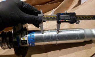

I am very happy with the 5100's. I swapped out all the stock shocks/struts with them and while the ride definitely feels more confident and stiffer, it is not too stiff.
When I first installed them, I used the 5100's snap ring (stock upper mount) to adjust the ride height to the highest setting (2.25" lift), and while at first it was a bit taller than my original 2" Rough Country Spacer Kit, it seemed to "settle" after a few months to a point lower than where the RC Kit was at.
The highest setting on the 5100's is 1/4" shorter than the spacer is tall, so I should have known this wouldn't have worked the way I wanted (2.5" lift). I eventually took it all back off and set snap ring to the stock setting and re-installed the RC Spacers to regain the lost height.
