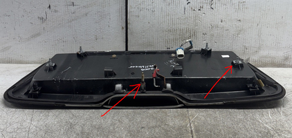

*ugly reinforcement for hatch license plate pocket hack*
On my pocket, the stud behind the handle is gone, and one of the side studs base is cracking.
(example pic from ebay)
Reinforcing bolts applied in areas where the plastic pocket rests directly on the hatch steel, so the pocket will not pull away from the hatch under normal use. Though I have informed fam members to just pop the hatch from the handle but pull from the bottom edge of the hatch.
