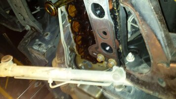

Here is an update with pics if it will allow me to share them.
Followed the directions to T, after getting it jacked up and on stands it took me about 1.5 hours to have the pan on the ground.
Found exactly what I expected to find, oil Sump screen 3/4 blocked off.
The pan has about a 1/4" of stuck together sludge, still there even from the previous attempts of cleaning it out with a cleaning solution and air sprayer to wash it out through the drain plug. Again thank you very much for your assistance it is greatly appreciated.
Wes1.jpg 2pan.jpg 3block.jpg 5.jpg .
Going to have to wash every thing on the lower end now I can see it..
Just hope upper side doesn't have such a surprise for me in the future.

Awesome it worked great was able to get some help to do this tonight and it worked like a charm.
Thank you all for the guidance on this adventure.
I noticed after pulling the balancer off, that there was like a washer on end of the balancer and after Googling it I found a Gm part number 12578073, it says its a crush washer/seal is it really nessary to replace as I did not know it was there when i ordered parts and I only have the week end to work on it ( days off ) for another 11 days ugg.
I really doubt that i will be able to get in by Saturday if ordered tomorrow.
Wife is really getting mean about this thing now :smile:
Wes...
We are with you Brother... I know you are anxious to get things buttoned up and running... but unless the Old Washer fits neatly and firmly on the outer rim of the inner snout of the Harmonic Balancer... you will run the risk of having a serious Oil Leak. Sit the Lil Woman down and tell her..."The More Haste... The Less Speed..." Call around to the local GM Dealerships and see who has this relatively inexpensive component. It would kill me to imagine you having to take this engine down for a Third Time.
Devil's advocate here :satan:
I did not replace mine with a new one with no ill effects.
IIRC it's a thin washer that is basically between the timing chain gear and the balancer? If that's what it is, I fail to see how this would cause a leak.
Reactions: djthumper
This link leads to a company that completely rebuilds Harmonic Balancers and provides an excellent retrospect about the purpose, origin and development of its designs going back 117 years ago. The in-depth article also gives some interesting ways to spot and diagnose the hidden causes of excessive engine vibration problems. Mentioned as being of particular interest to us will be the presence of unusual, shiny artifacts left in the outer Serpentine Grooves molded or machined into the Outer Mass Ring. There are quite a few posts here on GMT Nation that leave an often unsolved answer to “The Riddle of GM 4.2L Engine Vibrations” that cannot be explained in the absence of including the possibility of a declining Harmonic Balancer on engines with greater than 100,000 performance miles:
http://damperdudenz.tripod.com/id3.html
The main OT concern here is that with this “updated design”, GM cooked up an “Anti-Rotation Friction Washer” and it would seem impossible for something so massive and installed with such an enormous amount of force could ever manage to work its way loose. But the enormous forces at play along the centerline of the Crankshaft are such that without having a “Woodruff Key” to SNUGLY align and hold it in place on the nose of the Crankshaft… it CAN work its way free … and ruin the engine in very short order. Excessive engine vibrations, ruined Crankshaft Babbitt Bearings and of course… Engine Oil leaking from the Front Cover Seal are by-products of these is failures that accumulate over time and high mileage.
We already know how Massive and Heavy the average Crankshaft is when we take it out of an engine and lay it on the bench. Now imagine bolting the Harmonic Balancer on the end of it and then picking it up. You can get a better image of how hard it is for these two huge chunks of matter to stay “married” when they are back inside of the engine; one constantly vibrating while the other is fighting to absorb and dissipate the kinetic energy vibrations into heat energy AND slip and separate from one another at up to 5,000 RPM … you can get a dramatic idea of what a problem it would be … should they come apart or the Inner and Outer sections of the HB succeed in separating as well.
So in spite of the initial 110 Ft Lbs of torque and the additional 180 Degree TTY tightening force… the smooth inside diameter surfaces of the Harmonic Damper mating to the smooth outside diameter of the Crankshaft nose leaves an unfortunate ready opportunity for this loosening to occur. To counteract this tendency… The GM Engineers designed an “Anti-Rotational Rubberized Friction Washer” that sits snugly into, over and around a machined recess on the leading outside edge of the Harmonic Balancer snout. And once the huge TTY Crankshaft Bolt it tightened down, the combined friction between those two opposing points is the only thing preventing the Harmonic Balancer from coming loose and spinning freely on the nose of the Crankshaft. Without having any “Anti-Rotation Washer” in place… the proximity of the inside of the Harmonic Balancer can move close enough inboard to the Timing Chain Cover to make contact and it can shorten the lateral freedom of movement the Crankshaft enjoys inside of the Engine Block.
The GM Atlas Family of Engines are not alone in the use of this “Anti-Rotational Friction Washer” design, as it can be seen on the GM LS Engine series as well and in the case of the more powerful V-8 Engines… the exact same style of this seal… but theirs is “Diamond Impregnated” to improve its grip on its metal contact surfaces. This provides enough holding friction at the back-end of the Harmonic Balancer snout to securely hold the HB firmly and reliably in place while absorbing and dissipating horrendous vibrations whose amplitudes could climb rapidly enough to snap the HB right off of the nose of the Crankshaft and destroy the engine in matter of moments. Here is another interesting On Topic article worth reading: http://www.agcoauto.com/content/news/p2_articleid/273
Update: I was able to sew this animal back together, and the wife is once happy again. Now on too the A/C not cooling like it should and back blower not working.. small details :)
It running as good as a new one ( knock on wood ).
I would like too thank all for your help on this matter and express my greatest appreciation for your in depth assistance and knowledge - experience.
MRRSM , Thank you for this information , I will dive in and read up.
Wes
