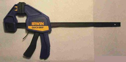

(5) It follows on that my solution will be to use either the 300 PSI or 600 PSI Irwin Quick-Grip Tools depicted in the attached images to slip underneath the Silverado Body Shackle Mount...then OVER the Outer edge of the Long Leaf Spring with the New Upper Shackle Bolted in place. This will allow for the gradual tightening and draw-down of all these components and align the Shackle Bracket and Body Frame Leaf Spring Support holes, making it EZR to pass the Thru-Bolt into the works and then Fasten everything together.

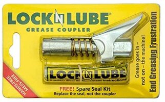

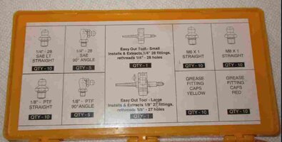

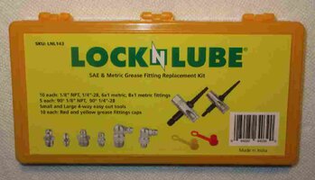

(6) Those of us following the "Tool Talk" Thread will recall the discussion that followed from my decision to purchase the Lock-N-Lube Grease Fitting Coupler for my Grease Gun and how well THAT thing worked out. In this situation. I was NOT happy with the Small Zerk Fittings that came with the Pair of Lowering Shackles. So I also invested in getting the Lock-N-Lube FULL Zerk Fittings Kitwith BOTH SAE & Metric Zerk Fittings in various sizes. The Kit also comes with TWO different Reamer-Threader Tools to handle any requirements for Post-Drilling and Tapping of any New Holes needed or the variety of Zerk fittings offered in the Kit.
(7) Finally, I used the Smaller of the two Irwin Quick-Grips Tools(300 PSI) to restrain and squeeze down upon the opposing sides of the Black Plastic Inserts after inserting the Hollow Shackle Bolt Bushing in between. To avoid having an “Squeaking” noises after setting the Truck on the ground and Torquing down the Shackle Bolts withe suspension "Weighted", I pumped the service Zerk Fitting FULL of High Pressure Grease. The Lock-N-Lube Kit provided Red and Yellow Plastic Zerk Fitting Caps to protect them from any Road Dirt & Grit.
