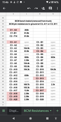

I will be travelling today but here is a test of some of my BCM readings measured on the kitchen table... For comparison sake..

this is good testing but not quite what I suggested / asked for ... sorry.
You need to measure like you have done but only points c3-a18 (ign0), c3-a19 (ign1), c3-a20 (ign3) and c3-b15 (accessory). make a table... each of those points need to be measured when the key is OFF, then with Key ON, and then with Key start. Hopefully, you understand. table with 4 points and 3 voltages against each point based on key position.
note that these BCM resistance measurements are somewhat similar / same as those posted by tjbaker. This would likely mean that he and you are testing the same way and the same module. I am not sure that we can say the same thing about the PCM results... I haven't gone backwards that far.
ALSO NOTE: you didn't measure the resistance of c3-b15 (accessory pin).
ALSO NOTE: that the resistances for input power look very similar for all inputs of 12v which one might expect.
