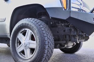

Saturday's main purpose was to install some BartonMD bumper action on Decembersend's TB. First, stock bumper cover's gotta go!
Here's a quick look at the new goodies. Had to disassemble the subs, so that made for a quiet drive up here. :mad: :tongue:
Game planning and removing the bumper support.
Test fit
Time for some grinding
After bolting it up, time to cut the wheel wells.
Not an official meet without 3 GMTs. Our buddy Jake from TBSSOwners dropped by to hang out.
With the wheel wells cut, time to install the projector fog lights, then reinstall the headlights.
A quick test to make sure everything is hooked up right...
And then all buttoned up and ready for the road.

:dielaugh: Come on man, you know how I do! We forgot to invite Ceasar, hope he doesn't get mad for that :redface:
Um... you were only supposed to grind the top of the frame flat... The bottom keeps its tube nubs... If you took the bottom flat, like the top, you'll want to take the bolts off and put (2) 5/8" fender washers between the bottom of the frame, and the bumper... That's the reason it's sitting a little close to the body in the "wing" area...
Also, the light mounts are long enough that you can aim the lights and then bend the mounts to put the lights in the middle of the holes...
Looks good, though!
Mike
Looks good on there. You only have the suspension lift right?
Bartonmd said:
Um... you were only supposed to grind the top of the bumper flat...
:duh: His wife was telling him that before he drove up here!! :hopeless:
Sorry, I meant only supposed to grind the top of the frame flat, for the bumper...
Mike
Now that I think about it, we did use some washers, but on the top of the bumper, instead of the bottom. I don't remember their sizes, but everything was pretty snug once we were done. Got a LOT of attention from people passing through while working on it. :thumbsup:
Yeah, the washers need to be on the bottom... The top bumper mount needs to sit directly on top of the frame... Since the lower tube nub is now gone, the (2) washers per bolt need to go in the place of the bottom tube nubs, between the bottom of the frame and the bottom mount of the bumper...
Mike
I'm pretty sure we put the washers on top of the bumper. David or Jimmy will have to confirm. I think I was running my mouth while they were tightening those down, so no pics... :redface:
I took a caliper to the bumper and it looked like it was made to snug the frame rail. He can always tap an alignment shim in there later
The washers were only added because the body lift bolts were too big and we couldn't get the perfect size bolts so we had to take up the slack to catch the threads. They are not between the bumper and the frame
Nope... Top smooth, bottom stock... It was made like that on Kyle's, and was on there, even after it was welded... Having been tightened down already, it's likely bent in at the bottom (Can see it in the pictures, actually), but it'll take a washer or 2 on the bottom, maybe with a little prying...
Mike
Yeah, he also needs to use his stock bolts, as they're larger than the body lift bolts (and they're stronger than grade 8)... Had I known he didn't have his stock bolts, I would have left the holes 1/2" like we had them on Kyle's, before I blew them out to 5/8" for the stock M14 bolts... The reason for using the stock bolts is because they fit tighter in the holes, and in the bumper holes, so that when you're winching at an angle, it doesn't rock the bumper up or down...
Mike
jimmyjam said:
I'm going to blame Carlton....
Shame on me. Guess we should take it off and ship it back to Mike then :whistle:
As I said, though, it's not a big deal... he just needs a pair of 5/8" washers on the bottom of the frame, on each rail, and to use the stock bolts...
Mike
