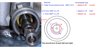

good evening everyone.
Please tell me about the angle of Turns Lock to Lock in Rack and Pinion.
The parts of the factory are equal to both left and right.
After rotating 360 degrees, rotate 270 degrees.
Round 1 and 3/4 on both left and right.
The new Rack and Pinion is not equal.
After rotating 360 degrees on one side, it rotates 270 degrees.
However, the other side is rotated 360 degrees and then locks around 180.
One side turns 1 and 3/4, and the other side has only 1 and 1/2 rotations.
This is before attaching to the vehicle.
I rotated it to confirm the centering.
I thought about being a defective product.
But maybe not?
For example, if Rack and Pinion is attached to a vehicle, fluid is filled and air is removed, is there any possibility that it will return to normal?
It looks like "SHIP OF THESEUS".
thank you.

The rack was confirmed before installing it to the car.
I turned the Rack shaft with a wrench and checked the center.
Therefore, it is not a problem that occurs after attaching to the EXT, but a problem of RACK itself.
Since the product specification is 3.5 revolutions, it is normal to rotate 1 and 3/4 to the right and 1 and 3/4 to the left.
However, it does not rotate 3.5.
Rack of the factory removed from the car rotates 3.5 revolutions.
Currently, RACK has no hoses, and is not connected to outer tie rods or steering knuckles.

The rack is centering on the garage floor.
What I am doing is:
The video rack
TOTAL TURNS Lock to Lock: 3.3
The purchased RACK is Total Turns Lock to Lock: 3.5.
Instead of the steering wheel, the RACK itself (probably input shaft in the video) does not rotate 3.5.

The following is the part that I was confirming.
It was not an advanced problem, such as the left and right balance. (lol)
Returns were accepted at 1st stage of poor illustrations.
I'm sorry, I wrote in#5 that I bought Edelmann.
Rack is new. Not Renufacture.
It was the most expensive RACK sold.
Of course, the price is not completely proportional to the performance.
The ACDELCO in # 8 seems to be Total Turns Lock to Lock 4 revolutions.
The RACK at the time of the factory was removed from my car was 3.5.
The product specifications of the RACK I purchased were 3.5.
> IF YOU PUT THE NEW BOTH SIDES EQUAL o THE PINION. IF You Turn the PINION EITHER WAY TO ALIGN It WITH The Steering Wheel Joint, it is No Longered with UNEQUAL LENGTHS OF THE RACK ON EACH SIDE. If this is the case, it was not presly PuttoGether.
I am worried that there is this problem.
The problem may be added after the current problem is solved.
But my problem is more basic.
Simply, the RACK shaft does not turn 360 degrees x 3.5.
