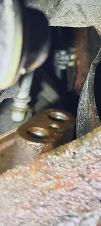

Need help. I was replacing the power steering lines due to rust and managed to over torque the bolt that attaches the lines to the rack and pinion. Does anyone know where I can find that bolt or the dimensions. I got the part out that snapped but need to replace it.
Could go to Lowes or home depot and use their thread checkers to figure out the thread then find a suitable bolt there. Just gotta figure out the thread and length of the bolt and you're set. Just gotta find one with a head size that doesn't interfere.
Just to clarify the Fastener Location... Can you mention which of these images is relevant? If its the one that holds the PS Line Manifold directly to the Power Steering Body (image from TV) I'm going to take a SWAG (Scientific Wild Ass Guess) that it is a Metric 10.9 Hard M10X1.25mm Bolt as per the eBay offer:

Sorry for bringing up an old thread but i managed to snap the bolt to my power steering also. Was wondering did the M6 x 1 size bolt work in replacement? Thanks guys for the help
You'll be best served with an M6x25 bolt.
The factory bolt is "special" in that it has about 7mm of dog point on it so that they don't cross thread it at the factory using power tools. You're going to want the extra thread because you'll be hand starting it and need the extra threads to pull the manifold plate to the rack and pierce the seals.

Mine came out just using a small magnet. It spun freely out. A regular bolt of the proper thread worked fine.
Yes, it is the one in the picture you show with the 2 hose connection points. It’s underneath the car in a really awkward place.

I'm very grateful to find this forum. I was duped (shame on me) into buying an '04 TB with the lines disconnected at the rack and the 8mm bolt snapped off.
How did you extract the broken 8mm bolt? Did you have to drop the R&P? While I found it easy to get to with a long and short extension by going over the axle (either from the outside with the wheel off or from underneath - just as easy) I can't imagine using an easy-out from that position. What size easy out - or other method - did you use to extract the bolt?

(4) The Retention Bolt is NOT an 8mm Fastener, per se... its Shank Dimensions make it an M6 X 1.00 X 25mm 10.9 Hard Bolt that requires drilling into the center of the remaining Broken Bolt Shaft with a Very Small Left Hand Thread Drill Bit FIRST in order to see if it will unscrew it without any fanfare. If at all possible... This work is Best if Performed in a Bench Top Setting.
(5) The important thing to realize is that once the Bolt has Snapped Off... THERE IS NO LONGER ANY STRESS BEING APPLIED IN BETWEEN THE REMAINING MALE BOLT THREADS AND THE FEMALE THREADED PORTION INSIDE OF THE POWER R&P MANIFOLD. Ergo... it should not require a great deal of counter-clockwise force to unwind the Broken Bolt Remnant.

You will have to drop the rack. The snapped bolt I was able to use a pick and/or a small magnet to spin it out. If that doesn't work, you could use a reverse drill bit. If that doesn't work, then an easy out using the hole you made. Replace it with a regular hex head bolt from a fastener store. Bring the broken stub with you for the proper size, thread and pitch.
