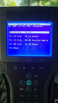

BINGO! That worked immediately. Thank you so much for helping me through this. One last question I think.. When I connected the Tech2 to my truck, while I was requesting info to update, it asked for my engine size. I have the L33 engine and that's not a listed engine. It has LM7 parallel hybrid listed, but not the standard LM7. Should I just click the "other" option if my specific engine isn't listed? The VIN is correct and that should specify my engine to TIS2000 as well as the Tech2, right?
What version of the Tech 2 software are you using? The software on the PCMCIA card in the Tech II is what I'm referring to, specifically. Should be 33.004.
Looks like my Tech2 is running 33.004 for it's software. This is the screen I see. I know I said L33 engine but it's (B) VIN. It's a 5.3, just aluminum block with a different cam and a few other slight differences.

It should be OK. I've used mine many times with Tis2000 however I use an old laptop that runs XP natively and has an actual serial port. Others have been successful with using VMs and USB serial adapters as per instructions.
