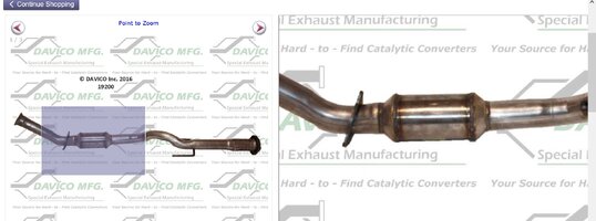

I need to find a replacement catalytic converter for my 03 ext. tb. I was having some overheating issues which lead back to a hole in the coolant loop (sucking air) after that problem was fixed I could not get the engine to rev over 1500 rpms. this lead to removing the o2 sensor for testing and I can now get up to speed without bogging down, so i am certain the cat is plugged. Im looking for a bolt on catalytic converter as I cant do the welding atm. is there a bolt on converter that people have had good success with? I am located in florida and we don't have any emissions to deal with. also so i dont prematurely wear out the new one should i be replacing/ testing anything else besides the t-stat?
are there any considerations/differences between the brands or personal experience out there? i assume the fitment for all ext. converters should be the same.
I have the Walker on my Envoy. Its smaller so its easier to install but after a few years I started getting p0420 codes so I just threw on an anti fouler. I had to cut the hangers off the original one to get it out without removing anything else.
That's the thing with any aftermarket cat, they won't last as long as the original. Looking at those ones at RA, the Davico look more like the original casings, round and fully welded, while all the other brands all look like a universal cat was welded onto the pipes. And the pipes look better. Just an observation, not any experience.

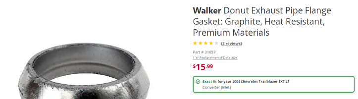

Get the OEM doughnut gasket if you can. There is a reason the aftermarket one is so cheap.
I went through three of the aftermarket gaskets before I realized that the OEM quality is much much higher than the aftermarket.
The aftermarket ones tended to burn out in a year or so and then you have to do the job again.

thanks to everyone for the help and guidance. these are the products I went with:
I also wanted to clarify as this may help someone else who is doing a cat replacement. there is only a gasket on the inlet side. the outlet side just mates together. so don't bother searching for a product that you cant find and dont need. i had no issues with the install of the davico cat. the t-stat is functioning properly and everything seems to be running correctly. it feels so good to have her back on the road. at 212k miles i think the cat just gave up. i couldnt find any obvious reason for its failure. i will update if there is any issues with this brand cat.

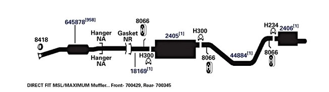

here is a few things i think may help. this is a picture of my outlet pipe reinstalled. the shoulder of one end is just pressure fit against the other. there is a gap between the retaining brackets but with the shoulder going into the outlet pipe is a very snug fit.
the haynes manual was extremely vague and had no pictures of any merit. i was however able to find a few other pictures online, so it must be true...
this magnaflow kit says: Gasket Or Seal Included: Yes
there is only a gasket pictured for the inlet pipe.
there is also a diagram i found:
if you see there is a gasket and part number on the inlet side. on the outlet side it says (gasket NR)
i am ASSUMING the nr is not required or something similar because there is no icon or part number.
All of this being said if your outlet pipe leaks with out the gasket and doesn't leak with the gasket i don't see the harm in having one in there but maybe i'm wrong. i hope this helps.
