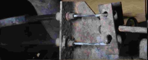

Another picture is where there appears to be a short metal line that is cut off at a rusted connector or end part and the one below it runs all the way across. What am I looking at and should it be two lines there with one short and one long that continues or am I looking at a broken/missing line of some sort?

Not sure on pic 2.

THIS Other Image tells ANOTHER Story altogether because is shows that when the Emergency Park Brake Handle is Lifted to apply the Parking Brakes.... Only One Side will respond... and very poorly at that.
This is because One of the Two E-Brake Cables leading either to the Left or Right Rear Brakes has Slipped through the Stamped Steel "Load Splitter" meant to take the energy coming from the Single (Pull Handle) Cable and then Equally Divide the Force into being distributed to BOTH the Left and Right Rear Wheels' Emergency Brake Levers via their Unique (L) and (R) Emergency Brake Cables. They are NOT Inter-Changeable:
img_20230218_105852291-jpg.106869
Your Rusty "E-Brake" Load Splitter is still there... BUT it SHOULD look very similar to THIS One when those Two E-Brake Cables are properly routed and in their correct, adjusted positions:

Looks like your parking brake system has broken cables in multiple places. If you want it to work, you may need to replace all the cables, including the one from the lever through the floor (pic 2). I've had that one break at the splitter.

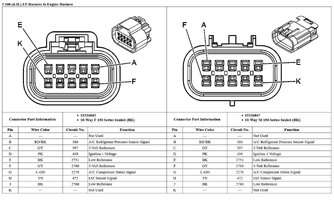

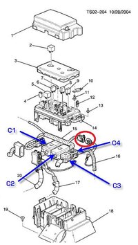

Thanks everyone. This is one of my last "what is this" for a bit. C1 splits to this connector and it's been flopping around not connected to anything for support getting crusty. From the connection, the other end runs into the harness under the manifold. I'm working in a dark shop without my phone that I downloaded manuals to at the moment. I take pictures but the colors aren't coming true and I'm having a hard time seeing what might be faded or a true color etc. Both ends of this are so full of gunk inside around the pins. I'd like to clean it up but I was just wondering what exactly this connector is or what I'm looking at for matching wires to where they go when tracing if needed. If that's too lengthy of an answer, maybe supply colors and I'll try to look when I get to my other phone.

View THIS Image (after a Deep Zoom) and the Connector you are looking at is probably THIS One (Circled in Red) as part of the Under Fuse Block Harnesses:
Note that in and around yours ...there are indications of Green Connector Corrosion therein and the Very BEST Stuff for cleaning out any Electrical Connectors and Switches that will actually work when the solvent is still Wet is called:

If I am seeing what I think I am seeing that is a connecter that splits off the harness PCM connector #1 (Blue)??
Reactions: Elizabetty
I think that may be X100 sometimes labeled C100. The red/blk is your AC high pressure sensor signal. I don't have (or cannot find) a 2002 pinout for it but a lot of it matches the 2006 pinout I have.
