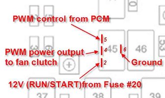

Good morning I need help... I have a 2002 GMC Envoy SLT. I don't have a scan tool with bio-direcrional controls, I couldn't get someone around me with Tech2 and I tried to get a Chinese copy but didn't work. And it was not for lack off communication with the PCM because my BlueDriver works just fine. I got a P1482, '81 & '84 so I replaced the clutch fan. I checked for continuity before installing it and inspected the wire connectors as well as the little cavity between the fan and the wires as indicated in one of the pics above. Once the replacement was done, I cleared the codes and a few weeks go by and the engine light goes on again but this time I only got a P1481. So this is what I've done but don't know how to proceed.
DMM
Set on DC/V-auto
Ground lead to battery ground and positive lead made measurements.
Connector 15326829
Pin A/BK/250 has a good ground
Pin B/WH/2368 = 11.16V
Pin C/GY/WH/2365 = 14.6V
Pin D/D-BU/2364 = 5.4V
Pin E/GY/597 = .217V
10A fuse
NOT hot at all times
Replaced fuse with known good and nothing
Cooling Fan Relay
Pin 2 = 3.7 mV
Pin 4 = 15.5 mV
Pin 5 = 1.4 mV
Pin 6 = 11.96 V
Visual inspection of the wire fron the fuse box to PCM seems ok. There's to many connections and didn't want to open them because I didn't know which one it was.
I'll say Good Morning as Well...and suggest that you Watch and Download the Scanner Danner Video I linked in Post #2 on this Topic as your Next Best Thing to having a High End Scanner. If you watch what he does and the steps he must take to Isolate the Control Circuit Failure, then you can replicate SOME of what his Tests are by using your Digital Multi-Meter with a slender Back Probe Pin to sneak into the Harness wires and compare what he shows on the Video with the results you acquire with your DMM Read-Outs.
Speaking of the use of an Oscilloscope ... Just to have the advantage of observing the Wave Forms after Analog to Digital Conversion for Low Voltage Network Diagnostics would be a boon in your present circumstances, so using one of these devices might work in your situation, too.
Since you have no access to a Tech 2 right now... One of these Combination 'Pico-Scope' & DMM for $90.00 would certainly extend your Diagnostic capabilities and somewhat emulate the Expensive Tools that Scanner Danner utilizes to hunt down this P1481-P1482 Fan-Clutch Mystery. . I'm not touting any particular one... but a majority of the Buyers of THIS thing seem fairly pleased with its versatility and performance for being a Battery Powered Hand-Held Scope that is under a Hundred Bucks.
Again... and as ever... Caveat Emptor (Buyer... Beware)
Reactions: Dreccomel

I got a follow-up question. What can I do when a fuse (that's ok) doesn't have power flow from the box itself. I check with the DMM and an incandescent test light. Does that mean replace or open the box?
Forgot to mention that I did watched the video and downloaded it as well for future reference.
If the 10 Amp Fuse in the #20 PDC is NOT Blown...and the Metal Female Tines have NOT been spread too wide (There's a Bad Joke in there...somewhere...) AND your Wire Integrity from the Truck Harness to the PCM has proven continuity... I'm thinking that your are STILL facing the same problem of a Sketchy Short running somewhere between the Plug at the Radiator...and the Wire Harness Plugging into the Heart of the Electro-Viscous "Hockey Puck" at the center hub location.
If you have not gone to all the trouble of using a "Spy Glass + Bright Flashlight" examination of the wires nested inside of the Shielding Tube like THIS Guy does in this next video... you simply cannot discount a physical, 'friction wear' issue of why the Harness works GREAT for quite a while... and then it Shorts out all over again.
When it comes to running down "Electrical Gremlins" like these... in many instances... Checking for continuity when the Vehicle is NOT Running and Gyrating or Vibrating around enough to creates the conditions of this Weird Short...will display Good Continuity... that will turn out to be a Temporary Phenomena once those other action dynamics kick in.

Dumb question... have you tried swapping the fan relay? it's the same as the headlamp relay.
BTW, it's not a relay but a PWM module.
I did...
If you actually read 🤔 the information you would know that the the issue is not the solid state relay but the fuse that feeds it, which its supposed to be hot at all times and it's not.

No prob bro. You know the ultimate and permanent fix would be to put in a thermal clutch from an 08 (even GM realized they were a failure) and have the codes tuned out. The tune is the difficult part.
Printable Docs from that Cool Video:
...and some additional helpful GM Diagnostic Flow Chart for the EV Fan Clutch and a Connector Breakout for Relay #45 (Courtesy www.theroadie.org):

quote: "Pin C/GY/WH/2365 = 14.6V"
if I read the posted schematic correctly, I don't think that this jives.
