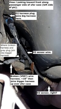

For the life of me I can't see nor figure where these broken wires go. I ended up buying a scope and taking some pictures. Any help is greatly appreciated! I'm driving short trips @ 15 mph with my flashers on! (And now a "Check 4WD System" light came on.)
Note: Gr/Bk should be Gn/Bk. VSS wires are Green/Black, Purple/White.

From my experience what is shown or otherwise detailed in service literature with regards to wire harnesses is not always exactly what is in the vehicle. So things may look a little different in the vehicle.
In a nutshell, your vehicle speed sensor needs to be connected to the engine harness. The engine harness at the transfer case is the one on the right side of the frame. This is the wiring left hanging in your pictures. It includes the C310 connector.
Those wires need to get over to the actual vehicle speed sensor. The service literature shows those wires going into the chassis harness near the junction to the transfer case shift motor.
From there the literature shows the vehicle speed sensor wires travelling in the chassis harness for a short while then exiting to connect to the vehicle speed sensor.
My guess is your vehicle speed sensor wires are broken inside the chassis harness on top of the transfer case where you will not see the break.

Thanks @TJBaker57! Finally, a passenger side view. Where do I find those diagrams?
Thank God for another set of eyes. And hands. My buddy reached up and found an empty harness. BINGO! Further up, on top of the transfer case, the harness is ripped open and you can see the green and purple wires (and others?).

Thank you all for your help and support. And outrageous thanks to my buddy who found the broken conduit that enabled me to finally fix the broken VSS connector wires.
I couldn't unhook the harness tie-down clip directly above the xfer case - and where the hole in the sheathing was - so I just ripped it off there and took the whole harness down. From there I could heat shrink the wires together and re-install with new sheathing. Whew! It works!
