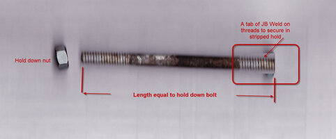

What I proposed would replace the existing hold down bolt with a stud. The stud wouldn't turn. A nut would be used to hold down the coil.
This is a simulated pix using a 1/4-20 bolt. It's been some time since I changed plugs so don't recall sizes.
