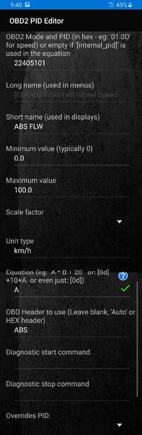

Mine is a 2008... Probably out of luck there
On my 05 Yukon 5.3 LM7 I get a value of one half the actual speed and the data is only received sporadically, like maybe once or twice in 5 minutes time! I need to have a peek in there to see just where that data is coming from
I had a look at the Yukon this afternoon in relation to this wheel speed thing.
Discovered that the value I am seeing from the Torque extended PIDs for GM ABS wheel speeds are bogus.
The data is coming from the PCM and is a normal class 2 broadcast of overall vehicle speed. Not in any way specific to individual wheel speeds. The PCM broadcasts this status report whenever there is a change in speed. The message is not a response to the Torque PID at all. Each one of those PIDs get updated by the same value. It's just random timing that determines which PID Torque is going to update.
Maybe these PIDs work in some other vehicle but the serial data in my case is conclusive.
Have you tried running custom headers? You have wheel speed sensors per wheel built into the wheel hub bearing assembly. The EBCM has to have these values to operate properly. Have you tried reading Bytes A-F? Edit: sorry didn't have time to read fully your previous post.
It's an 08
May still work but you have CAN protocol. Pids will probably be different. Alternatively you can use those same pids and try changing header to auto or leave header blank. Edit: omit the "h"

Had them displayed... No response at all while moving.
Try this header 8CFEF8. You'll see a list of responses look for the last 1 to 2 bytes on the very end. Any change will show you a response to the PID running that header. That header broadcast to all modules on a VPW Bus in your vehicle.
