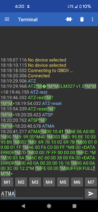

so got a min to see if I can connect. looks like I could connect but the only command that did anything was ATMA. that's just key on engine off.
I'll attach a screen cap. but since mine is the newer can type should I be trying different commands? and should those commands show like a constant flow of information. or just a quick screen snapshot grab.

The screen shot indicates you are connected so that's a start. Based on prior comments in this forum, I *believe* that monitoring all modules on the CANBus very quickly results in a buffer overflow (as is apparently shown in the screenshot above) so the next step is to identify the messages containing the data you need and the modules responsible for transmitting & receiving providing that data. You should check out the section entitled "CAN Messages and Filtering" on page 41 of the ELM327 reference document. Looks like you also need to set the terminal to do a CR or LF for each new message (not sure where that is, sorry). @TJBaker57 will know where to take this from here.

Post 447, the screenshot:
1) you entered "ATZ-reset". ATZ is a complete command, nothing is to be entered after it. The "reset" part is not needed.
2) you entered "ATSP". The ATSP command is not a complete command and it DOES need an additional parameter. Additionally, I would use the command "ATTP" instead. It is similar but does not cause some troubles that using ATSP can. In the data sheet for the ELM327 chip (page 35) is a listing of the available possibilities for both the ATSP and/or ATTP commands.
3) I will echo azswiss comment about setting an option for end of line character(s) in the serial terminal application settings. Every place you see an occurrance of "^M" is a result of an improper setting for "end of line" in the terminal app.
4) I would add the command to turn on the terminal applications display of message headers. This makes it possible to see where each message is coming from. The command is "ATH1". Send this before sending the ATMA command.
5) As you noted your buffer fills quickly. The data stream in CANBUS is very fast and there is no way for these little OBD2 adapters to keep up with displaying it all. For this reason you will need to explore a few options/commands for filtering the CANBUS data stream. As mentioned by @azswiss, Pages 41, 42, and 43 of the ELM327 data sheet deal with some of this. Here I cannot be of much help. I have noodled around a little with these concepts but never gained a good footing.

I did the same command twice and got totally different set of stuff, and that was just engine off doing nothing.
Not surprising since the amount of CAN traffic is overwhelming the buffer on the ELM327; you are taking a small snapshot of a constant firehose of activity. This is why filtering the data is essential.
@TJBaker57's advice regarding headers is key:
Filter by Transmit or Receive module via the AT MT xx & AT MR xx commands, respectively, or byte filtering using the AT CRA command. Identifying the appropriate modules and/or bytes is going to take some experimentation; trial & error coupled with some fortuitous Googling.
