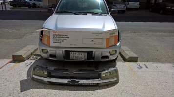

Well took the lights off from the TB today!
Will be redoing the front for the zombie apocalypse :hahano:
Was about to bake them until I realized I have a gas oven and thought it would mess up the lights, so as it sits right now I've got the grill removed. Will be taking it to a shop to get the headlights opened tomorrow hopefully:Banghead:

After going through the article section and reading the article written by....... @Blckshdw , I started by putting the lights in my oven and slowly working my way through them. Five hours and I have the lens loose but still not off! It's like GM made these headlights so no one could open them!!
Pre-machine era retrofit
You must mean "error" we have already mentioned it countless time that you cant bake the oem head lights open. Your attempt with a hack saw isn't going to get you any closer either. I hope you have another set of lights for your blazer cause your build is going left really fast.
@$ Khalid ! 9130 you're also cutting where I said NOT to cut. You need to cut along the rear edge going around the headlight, not the outer edge. You just need a groove on the back so you can fit a blade above AND below the lip of the lens. There's permaseal in both places.
I realized that after all that work that out would've been easier that way :duh: . Maybe the other side will be better. Or should I stop before I fly too close to the sun and burn :confused:
