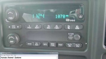

im trying to swap to leds in my 2005 colorado factory radio. i have been searching everywhere online for the polarity of the factory bulbs and cannot find them. does anyone have a link to a how to or anything that would show this? it has the exact same radio as a 2005 silverado. i have uploaded a picture of the same radio i have.

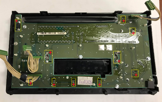

I realize this may be way too late for you, but it might help some others.
This stock GM/CHEV radio can also be found in vehicles such as Silverado, Sierra, Tahoe, Yukon, etc.
There are 3 bulbs that are 4mm, and 7 bulbs that are 3mm I believe. 10 altogether. It's all 12VDC and they're all in parallel.

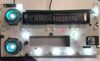

Here's a picture of the radio with the blue LED's. I used blue because I ordered a stepper motor kit for the instrument cluster and it came with blue, red, and white LED's. I used the white for the gauges, so I chose blue instead of red for the radio.
As you can see, some buttons light up brighter than others and there are some hot spots. I tried to add a few layers of foam inside the volume and tune knobs to see if I could dim the light a bit, but it really didn't seem to make a difference, so no point in trying elsewhere. I'm not sure exactly how you could get LED lights to be more even without hot spots in this radio, other than maybe using 3mm bulbs like where they did stock. I'm not entirely convinced myself that simply using a 3mm bulb would be that much dimmer considering how all the bulbs are placed behind the buttons. It's much better than all the lights being burnt out though.

Initially:
Now:
The left pic shows the balance and uniformity better and the right pic shows the blue color better. There's only miniscule differences now.
I ended up using some packing foam I had lying around to dim the hot spots and even out the rest. Some was clear-ish white, about 1/8 inch thick, and fairly dense, while some was black, about 3/8 inch thick, and very soft and porous.
For the knobs and bottom row button hot spots, I cut out the black foam to fit into them. The knobs and buttons are all indented and hollow inside where you can stuff the foam into. I cut pretty precisely so the foam wasn't compressed very much.
Where there is 1 button that's split into 2 selections, I had to use a much smaller piece of black foam and only cover just the bulb in the center of the button, to block the hottest spot. That way the stock diffusers inside could spread the light to the outer sections of the button which gave an even glow. This all worked extremely well. I only ever needed 1 layer of black foam.
The row of buttons directly below the display got filled with the clear-ish white foam since there's only 2 bulbs for that row of 4 buttons, which have 2 sections each. This added a secondary diffusion layer to the stock diffusers, which weren't spreading the light well enough on their own. This also worked out extremely well. I only ever needed 1 layer of white foam.
I'm pleased with how it's finally turned out.
