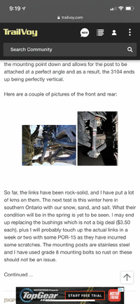

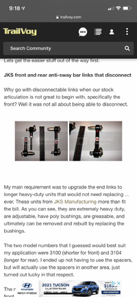

I saw one thread on offroadtb of someone using the jks 3100s, direct fit with no mods is wat he said. He even had pictures of them installed. He had em in the rear as well but a different model number. Ill post some pics of wat they look like

That from AlekG?
Reactions: 02trailblazerLS
Prolly where I got the idea of using stock JK ones. I wrenched on lots of JKs over the years and used to try to adapt all kinds of things.
Those look like they should work with the ends being able to rotate to any angle. The stock JK ones are fixed.
