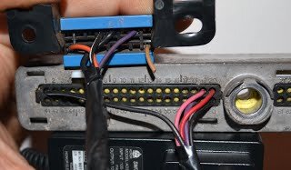

This is a “How To Build” of a Generic GM LS Style PCM-To-OBD2 Bench Top Test-FLASH Harness as listed at the below link.
Disclaimer:
For my own understanding… It was necessary to edit the writing and expressions (but not the content) of this material over to a common standard for describing all of these components and their connections, as I found the original writing very difficult at times to decipher. I make no Claim to being the Originator of these Ideas, Designs or the attached Images and all First Person References that follow in the text pertain strictly to those of The Original Author and Creator of All This Material.
If you prefer reading the Author’s original text... it can be found here:
https://sites.google.com/site/sloppywiki/tuning-information/obd2-bench-harness
Sloppy Mechanics Bench Flashing harness build sheet and instructions for obd2 (blue red/green) style LS ecu's (and some more)”
Components:
1. 12-19 VDC Power Supply, 1amp min ( I have used 500ma, but would recommend staying above One Amp
a. These are very easy to find in old hardware, chargers, external computer components like hard drive enclosures and modem power supplies etc.
b. I have tested 12-19 volts without a problem, that being said, I would stay closer to 12-14 VDC as this is Voltage Levels that most cars use.
2. GM Blue ECU/ECM/PCM(80 Pin Connector)
a. This Connector directly interfaces the ECU.
b. The Connector is usually held in place with a 7mm Bolt to prevent Accidental Disconnection during FLASH and avoiding Unplugging and Bricking anything.
3. In-Cab OBD2 Connector
a. These can be found in JY inside GM Blazers and Cavaliers and so are already Pinned for GM ECMs.
b. Make certain it has Orange, Black and Purple Wires. If so… The rest is EZ.

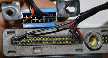

Component Assembly:
1. On the Power Supply, strip the wires and test them with a Volt Meter to ensure that it works.
2. You’ll have to flip the connector’s wire side towards you. On the BlueECU Connector wherePin 1 is located in the upper left corner, Pin 20 is located at the Far End of that same Row. Pins 41-60 are likewise located on the Bottom Row. Only 4 Pins are necessary for this to function … the rest can remain in there, or they can be de-pinned to clean everything up.
3. Position the OBD2 Port Connector, with the Wider Side Facing Up and the wire contact points facing you displayed as Pins 1-8 situated at the top, and Pins9-16 located at the Bottom. You are only using 4 wires on this Connector…with the others mentioned below dedicated to the 12 VDC issues.
4. Take the Positive Power Wire from the Power Supply, and connect it to Pins 19 and 20 on the Blue ECU Connector, (in the Upper Right Two Pins) and then connect it to the OBD2 Portat Pin 9 (Located at Bottom Left).
5. Then take the Ground Wire and connect it from the Pin 1 (upper left) on the Blue ECU Connector over to Pins4 and 5, (upper middle) on the OBD2 Port Connector.
6. Then take the Purple Serial Data Wire and connect it from Pin 58 on the Blue ECU Connector(lower right side) over to the OBD2 Port Connector Pin 7 (upper right side)
Now before doing anything else, Plug it in and see if you can access the ECU with whatever you are using on the OBD2 Side. Ifyou can Connect/Read/Write,then You Are Set.

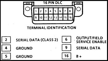

In Brief… USING JUST THE FOUR WIRES and the POWER SUPPLY CONNECTIONS:
Connect the 12VDC (+) Power Wire over to OBD2 Port Pin 9 (Orange) and to Blue ECU Pins 19 and 20 (Pink/Red)
Connect the Ground (-) Wire from the OBD2 Port Pins 4-5 over to Blue ECU Pin 1
Connect OBD2 Port Pin7 (Purple) over to Blue ECU Pin 58 (Serial Data Line)
Done!

As shown in the Image…Pin 60 does NOT need to be used (It was attached during testing and just left it in there). The same applies to Pin 16 (Brown Wire on the OBD2 Port) ...as it was clipped off during the JY Claim and it was just never de-pinned.

If you have a “GYMKO” Tech2 or a Laptop equipped with a USB to OBD2 Cable and whatever flavor of Scanning-Programming you favor … For you folks who own GM Vehicles equipped with either the GEN III or GEN IV V8 Engines instead of the GM 4.2L LL8 I-6… some of this harness equipment can allow you to fairly easily do 12 VDC powered PCM Bench Diagnostics and Custom Bench Top PCM FLASHING with some well explained and easy to understand designs created to work with the “411” Style PCMs with BLUE and RED 80 Pin Connectors.

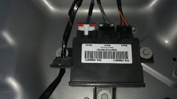

This morning... I brought out the Used and Well-Worn Donor GM 4.2L PCM ...which I will affectionately refer to henceforth as "Old Smokey" because it very much appears that the Trailblazer of Envoy this PCM came from ...Died an Ignominious Death at the Hands of a Raging Forest Fire...and the resultant Sooty exterior and Pungent Burnt Pine Odor is a dead evidential giveaway that this is what happened.
Nonetheless... it suits our purposes in its "After-Life" as a Test Bed for The Gymko Bench Test Harness. I took some snaps of the Damned Thing just before I discovered that it was impossible to remove the Rusted On Three Fasteners that seem to have an odd 6.5MM Hex Bolt Head Dimension and I was reluctant to bear down too much without first soaking the Lil Devils down with a healthy dose of CRC "Freeze-Off" Rust Busting Stuff.
This is NOT Recommended for Use on PCMs Installed and In Use on ANY Working Vehicle...!. I'll give them some time to mend their rusty ways before I venture out into the garage and try to unwind them... so that We can get on with our Autopsy of "Old Smokey" :>)
Okay… I finally got the rusted on Trapped Fasteners for all three PCM Connectors to ‘relax and unwind’ and allow me to pull all three. I decided since the suggested Schematic and Diagram designated that only the BLUE and the NAT (TAN… but it looks WHITE to me…) Connectors are involved in the making of the GMYKO Bench Harness….
This observation would concentrate my efforts into taking only the GRAY One apart to determine how much of a hassle it will be to de-construct the other two ...then ‘de-pin’ the both of them and build those two right back up with only the (4 Pins) necessary cross-connected wires that feed back into the back side of the OBD2 Port portion of this Harness. It became necessary to use a Center Punch and Plastic Mallet to drift out the Lock-down Trapped Fastener, ruining the Spring Steel Keeper Washer but allowing further disassembly afterwards.
These things are a lot more complicated than you might think they would be... on first blush… But actually they behave like a Chinese Puzzle Box… the more you take them apart… the more you find left that you have to take apart! In any case… I wanted to faithfully record this procedure and I wound up needing 42 digital images to get all of the gory details… ergo… you can view this work over on my Photobucket via this link:
http://s557.photobucket.com/user/60...ENGINEREPAIR/GM42LPCMCONNECTORS?sort=2&page=1
One of the images shows how I selected out one, thicker Orange Colored Wire that obviously is intended for carrying the Full 12 VDC versus the other wires which appear to a lot less ‘chubby’ and in all likelihood only have to carry 5 VDC for signaling and communication with all point and contacts within the Vehicle.
The other significant observance here is how incredibly robust and “gummy” the Outer Connector Seal and the Inner Wire Matrix Guide Seal are… sort of an OD Green and apparently… virtually indestructible. The individual Wire Female Post Connectors also look very sturdy… nonetheless… being as tiny as they are… I’d suggest using a pair of Needle Nose Pliers when installing them onto and over the (4) requisite Male Pins once they are connected to the right source wires coming from the OBD2 Port.
When next I can attempt that portion… I will use some Black Heat Shrink Insulators and make them all as durable and protected from short circuiting as possible. I will attach just two images to this post; one that shows a‘straight down the barrel of the gun’ view of these blocks of Pins and the other is of a Single Female Pin Connector and attached Wire.
I stress that it makes perfect sense to use just these individual Pin-Wires rather than attempting to De-engineer the brilliance Delphi brings to their manufacture of such lasting and functional components… and more or less, it allows me to take the EZ Way Out and still hope for absolute success when building the GYMKO Bench Test Harness in this abbreviated way.
This may be one of those rare instance where my doing it thusly will make the doing of this job for anyone else interested in attempting it ...just as easy:

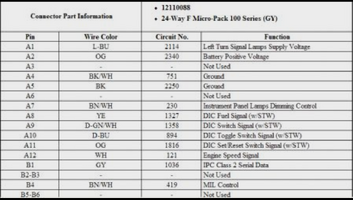

I spent some time this morning pondering the fact that the GM 4.2L P-10 Style Connector Diagrams for C1,C2 and C3 were showing the positions of each Pin as they sit inside of each Connector while looking straight down at them to give a True Positional Reference of them and indicate what they look like with each individual Pin-Wire poking through from the OUTSIDE of each Connector.
But what they DO NOT Show is the PCM side of the interface which... unless I have my Spatial Orientation wrong.... should be a MIRROR-RORRIM Image of each Plug-In Connector...and therefore ... the Diagrammatic References for each of the (4) Special Pin Connection points for each of the In-Coming Wires (Female Pins) to the PCM will be BACKWARDS.
To clear up any confusion about what this means until I can dope out all of these weird realities and create a PCM Side Pin Attachment Image Map... I decided to create Mirror Images of all of the Original PCM Connectors and name them so... just to make sure that anybody building their own versions of this GYMKO Bench Test Cable does not go to all of this trouble only to find that they accidentally Burn Up their PCMs by not realizing that the two sides of the Interface between these components... are Dopplegangers.
My advice is to wait until I set mine up and have a chance to test these ideas out on "Old Smokey" first... and either confirm that the cable works well with the "GYMKO Tech2 Scanner... or that it fails to do so. Please be assured that I will keep at it until I am certain that it all works reliably before saying that it is an absolutely Fool Proof GYMKO Bench Test Harness... (See the Attached Updated and Mirrored Images)

Okay... Just as I suspected... indeed the GM 4.2L PCM Pin-Out Diagram (which I have just finished preparing) is an actual "Mirror Image" of the Three BLUE, GRAY & WHITE Connectors. I was very careful to use a Flashlight shining through the front side of the "Positive Pin-Out" views of the Blue and White Connectors so I would have a better understanding of how to create the PCM Version and not make any mistakes with all of the bewildering possibilities staring right back at me.
I have double and triple checked my referencing on this image so that I would not make any mistakes in Pin Choices and decided that for the sake of the Viewers and Users of this information... Laying out an overlay of those locations Literally in Black and Gray and White seems to make a lot of sense in helping to "PIN" Down the Connections coming from the OBD2 Port (Female... Pre-Wired) Connector.

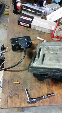

I made up one of these set ups a year or so ago just to see if I could re-flash a pcm. It worked BTW. When I first tried it out, I used a simple code reader to connect to it so if I messed up, I wouldn’t be out much.
Encouraging words, Brother... Was it for the same PCM? Does anything look wrong so far in the layout I am using right now that leaps out at you as being something I need to modify? Is there anything I can simplify further?
My insistence on using only the OEM Pin Wires has to do with not wanting any of them to loosen up at any time during the Binary Hexadecimal Transfers if I do as you did to either Clone or re-flash this style of PCM.
I had thought about placing an inline Fuse for 3 Amps or lower using an Audio Style Glass Cylinder fuse in between the PCM and the OBD2 Port ... but with using the OEM 12 VDC @ 1.5 Amps I am hoping no damage will occur. If you still have your harness and it has this feature... it would helpful to see what you created.
Using the Delphi sub-components is my own personal preference for this project... but that is not very encouraging to others to follow suit since the C1, C2 & C3 OEM Connectors are not ubiquitous... So a less expensive component “recipe” that will still offer reliability would be very welcome here. I always appreciate your ideas.

Well… to my very great surprise… IT WORKS! I took my time going over the original GYMKO (4) Wire Harness and added in the other (3) Switched Power Connections without making the harness too unruly. Compared to the very comprehensive apparatus that was designed and assembled by @Bill Reid into what would probably cost around $500.00 at bare minimum to have him prepare such a thing for purchase and use… Mine?
Not so much… It is limited to powered Bi-Directional Communication JUST between the PCM and the “GYMKO” Tech2 Clone Scanners… and I realize that when it is laid out loose on the Bench… it pretty much looks like a Dog’s Breakfast... Until you PLUG IT IN and find out that IT WORKS!
For this Post… I have only attached (3) “Proof of Concept” images of the Finished Harness and showing that when all plugged in, everything worked properly with “GYMKO” Tech2 Screen Images showing that IT and the PCM were able to get along just fine.
By the way… the Rocker Switch has an in-dwelling “Blue LED” that lets the User know whether or not it has been accidentally turned on prematurely... when it should be switched OFF until the Tech2 Clone is connected and Fired Up FIRST.
I tested the interaction between the PCM and the Clone Scanner… both with and without the Rocker Switch being turned on… and everything worked perfectly. I’ve posted the rest of the Final Harness Design, Tech2 Screen Images and the HW set-up images over on my Photobucket site linked here below:
http://s557.photobucket.com/user/60...KOTECH2CLONE/PCMBENCHTOPHARNESS?sort=2&page=1
I tried to measure out and cut all of the remaining wires in relation to the New Rocker Switch first, so their addition to the existing Harness would not need very much if any modifications to pipe in the (+) Power and (-) Ground wires to the PCM. I used three more of the OEM Sacrificial C2 Pins necessary to make it all the proper Pin-Out Connections function.
I decided that since the Three Position Rocker Switch is sub-powering the PCM Ignition Switch Circuitry and that adding in another 2 Amp Fuse-able Link branched to the New Switch (side by side) with the original made good sense... just to be on the safe side.
If you are going to construct this type of Harness… you will need to Pre-Cut and Pre-Arrange EVERYTHING and make certain that all of your various colored Heat Shrinkable Wire Insulation Tubes are likewise, also cut to size and then slid onto the various individual and bundled wires groups FIRST… well in advance of your careful soldering.
Avoid using Too High of a Heat Setting on your Soldering Iron as the innards of the Rocker Switch will overheat and Melt itself to Death with too much exposure to High Temp… (ask me how I know…).
When it comes time to TEST IT OUT... Be sure to PLUG THE OEM HOUSE AC/DC POWER SUPPLY CONNECTOR INTO THE OBD2 PORT ADAPTER FEMALE POWER INSERT... AND NOT INTO THE BASE OF THE "GYMKO" CLONE ITSELF...OR THIS HARDWARE ARRANGEMENT WILL NOT WORK!
In a few days from now... I'll spark up the Dell Precision M65 Dedicated TIS2000 Laptop and attempt some SPS software Serial Port Communication and experiment on "Old Smokey" just a little and see if I am able to do anything worthwhile with this Derilict PCM.
All of the Related Wiring Diagrams, Component Pin-Outs and Wiring Placement Images are also Posted for future reference on my Photobucket. They will be easy to refer to and anyone can Download, Print and Follow them by those who decide to create their own flavor of:
The GYMKO Bench-Test Harness

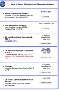

(3) Add-Ins: Having spent more than a little time looking over @Bill Reid ‘s work on his Schematics showing other Modular Connections such as the BCM and the Radio… I thought… WTH! I’ll check out eBay and Amazon and hopefully find a Cheap BCM to experiment upon and then re-arrange the necessary Wiring for the Add-In to the GYMKO Harness; extending the testing possibilities to include other Programmable Modules.
To that end… and for just under $26.00 with Free S&H… I located THIS GM Trailblazer-Envoy BCM ...which included The BCM… Three Harness Connectors, The OEM Wiring Pigtails and The Mount as a single Unit (See Attached Images).
I bought it in hopes of adding it into the mix and allow for the chance of testing out using the GYMKO Bench Top Test Harness in a harmless way to learn how to use the SPS Programming coming FROM the Dell M65 TIS2000 Box… via PASSTHRU using the “GYMKO” Scanner and observe the Back and Forth, Give and Go between the Body Control Module and this whole innocuous Bench Test Harness apparatus... and see what happens.
If this effort works… it will extend my understanding SPS and it should be recognized here and now as an extension of the work @Bill Reid has previously done so well because I will be using HIS Schematic to re-design the GYMKO Bench Test Harness for the inclusion of the Add-In Module:

But we can profit from the fact that the OP of this issue took some excellent images of the wires openly exposed and this gives me a clue at to which of them are for (+) Power, (-) Ground and Signal Wires needed to perform Serial Data Communication with the "GYMKO" Scanner.
If I can finish tracing these down... in the absence of having any available actual Pin-Out Diagrams of the Three Connectors of this LGM... at a minimum...I might be able to figure the correct Diagnostic Wiring of this thing... before the LGM component arrives via eBay:
LGMTHRUTHEBOOTWIRING.jpgLGMTHRUTHEBOOTWIRING1.jpgLGMTHRUTHEBOOTWIRING2.jpgLGMTHRUTHEBOOTWIRING3.jpg

I was just thinking about the First Video in Post #1 of this Thread and I realized from a Still Shot Closeup that the VOP's "GYMKO" Scanner is NOT being parlayed through the Bench Top GM 4.2L PCM in conjunction with the Instrument Cluster... but rather it seems to be connected to Loom Connector Pad with the required wires running from the IC (24) Pin Wire Pigtails directly over to a dedicated OBD2 Female DLC Port... and the "GYMKO" plugs into it from that point.
So with this observation in mind... I see no reason not to use the second OBD2 Port Connector I have on hand to experiment by creating a separate, small dedicated harness... just to investigate the LGM (Lift Gate Module) All by its Lonesome!

Okay… Tonight, the 2nd LGM arrived from eBay and for costing only $14.95… it turns out to be in MUCH better condition than the first one was in and will now become the focus of my attention … at least until the TCCM finally arrives and then I can dive in and tear that one apart as well.
Right now… The Big Mystery is… Why in The Name of God’s Holy Trousers… am I unable to find ANY specific LGM Connector Wire Pin-Out Diagrams to be able to decipher which one of “The BLUE Wires” is the Primary Network Signal Wire (and or the OTHER 5 Volt Low Reference if FOUR Wires are involved) needed to complete the basic Three or Four Wire Set Up needed to communicate with the “GYMKO” Scanner?
Really… Honestly… ALL I want to use this Damned Thing for is to continue to Add Several Different Modules to my Test Regimen and prove out this idea out that by using Simple, Discreet Module Wire-To-OBD2 Harnesses… any and all of these Modules can be interfaced with the GM Tech2 Clones using Class Two Data Streams and be adjusted or modified or uniquely REGISTERED on The Network of ANY appropriate vehicle by using the TIS2000 SW in a PASSTHRU configuration via the Dedicated Laptop; not inside any of the Trucks or SUVs during a Rain Storm Or a Snow Storm… BUT……...ON………THE…….BENCH!
Kansas Cows…! Why does THIS have to be so damned difficult? Fortunately… there are only about four different colors of “BLUE” amongst the Three Connectors available to test, but STILL… I am very reluctant to Power up the LGM Logic Board (which I know absolutely nothing about) and God Forbid, Screw up my Clone Scanner by grabbing the WRONG “Blue” Wire! These images will show a nice (better) contrast between the first LGM I picked up… and THIS one:

I can't believe my Good Luck in finally running into a proper C1,C2 & C3 TCCM Wire Pin-Out Diagram... and this one comes from a 2006 Buick Ranier, no less. But after scouring The 'Nets and coming up empty handed during the last few days... Getting my hands on THIS thing is a Welcome Sight!
If you look over the diagram, starting at the Top Left area of the image.... You'll notice that I have isolated what I believe will be all of the necessary wires to mate up with the Female OBD2 Port wires... nested inside of a those few Red Rectangles.
I'm not certain just yet... but I don't think I will need to add anything other than the (C1) Class 2 Serial Data Dark Green and White Wire, The (C3) Orange (+) Positive 12 VDC AWG Wire, The (C1) Black and White (-) Ground Wire and The (C3) Solid Black (-) Heavier Ground AWG Wires needed to make this thing work.
There may be a need to add in a Blue LED Lighted ON/OFF Switch to the Circuit and also a 5 VDC Low Voltage Reference Wire or Two from the (C2) Connector. But presently, I do not recognize such to be documented within this particular Diagram, as it is a dedicated, discreet Module that neither connects Directly With... nor Indirectly To (or through) the PCM in order to perform all of its functions. I

The “True” BCM came in late last night and once again, I took the time to clean it up, dis-assemble and re-assemble this portion that also requires a special Cable (on the way…) and a Fuse Block that is attached as well (not necessary for our Testing Purposes).
THIS is the hardware that [@Bill[ Reid worked on to create his Special Harness and power set ups that are much more durable and manageable when assembled as he describes and using exterior Box Compartments and Switching which I intend to side-step using only the GYMKO Adaptive Bench Test Harness. I have attached the images of the BCM showing the various stages of its dis-assembly and re-assembly below:

Let’s move onto the CLASS 2 Serial Data network. Some GM vehicles started using Class 2 Serial Data network system in 1995, which was also the phase-in year for ODB II. Since then, Class 2 is becoming GM’s predominant network system. Modules on this network system share information and each one can transmit and receive messages.
The following summarizes Class 2 Serial Data: The network uses a zero to Seven Volt signal; the voltage rests at Zero volts when there is NO communication; the transmitted data is a variable pulse width signal; Class 2 is found at Pin # 2 of the DLC, and is a single-wire network system; and GM uses what is referred to as a “splice-pack” to connect modules and the DLC to each other for network communication.
The Class 2 bus circuit number and the wire color for this system, each vary, according to the individual module(s). To diagnose this network system, you will require the following: A lab scope and scanner; a high-impedance DVOM; a component locater; a vehicle-specific wiring diagram, which is very important to have; and most importantly, a healthy dose of patience.
To confirm if the network system is operating as it should, hook up the positive lead (Channel # 1) of the lab scope to Pin # 2 at the DLC and ground the lead connected to either Pin # 4 or to the chassis. Next set the voltage setting to Five Volts and the time base setting to 100 ms (recommended). With the ignition switch OFF, there should be NO data being transmitted (NO voltage).
Now, turn on the ignition switch and you should see the following signal, as shown in
Diagram D. (Sorry... No Diagrams came over... I have attached Exemplar images to this Post instead fro a visual reference...)
If the signal you see is not as shown above, you can adjust the time – base setting of the lab scope, to your personal preference.

"TRUE" BCM Tear-Down and Class 2 Network-Splice Pack Images:
DSC01609.jpgDSC01610.jpgDSC01614.jpgDSC01616.jpgDSC01618.jpgDSC01619.jpgDSC01620.jpgDSC01623.jpgDSC01625.jpgBCMCONNECTORS.jpg2008_GM_truck_protocol.jpg90SCORVETTESPLICEPACK.pngSPLICEPACKLEADING2OBD2PORT.jpgPCMNETWORKEDCOMPONENTS.jpgDATABUSDIAGRAM.jpegBCM2004DIAGRAM.jpeg
In order to create a separate GYMKO Bench Top “TRUE” BCM Test Harness… I’ll be using the information found within this BCM OEM Connector PDF to identify and wire up Two out of the Three Connectors that reside inside the SUV within the Rear Under Seat BCM – Fuse Box Harness to create something distinctly OEM that will be hard-wired and soldered from scratch.
But... I will NOT be using any of the Very Expensive GM OEM Connectors that are available from the GM parts direct sourcing. Obtaining the usual, ‘Old Harness Cut-Off Connectors with Pigtails’ will be next to impossible out of Salvage Vehicles without having to extract the entire Interior Harnessing and pay for it as a complete set up and wind up making more trouble and work for myself than is actually necessary.
Instead, I’ll be using Mouser Electronics to purchase these ‘HTF’ Hard To Find Connectors using the Delphi Parts Numbers from the linked PDF and obtaining these Delphi connectors ...NOT for around the $60.00 amount they are asking for only one of these components…. But by purchasing TWO of everything; with the exception of the 40 PIN Bizarre Cable to Pin Connectors; ALL for Under $18.00 ... with S&H included from Mouser Electronics.
So… If you need to locate VERY HARD TO FIND, OEM QUALITY CONNECTORS… Keep the link below to the Mouser Electronics site at your elbow and You Will Save Tons of Money!

This is what these arrays look like after comparing and linking the Alpha-Numeric BCM C1, C2 & C3 / Radio C1 Connectors versus their interface with the Numbered PCM Pin Connections. In each case, the “Hollow Male” Pins I scavenged from the PCM/Delphi GRAY (C2) Connector will be used for the PCM Connection-Side of this arrangement … and for the BCM Side… there are Small Pins needed for the C1 and C2 Connectors as well as for the Radio C1 Connectors.
I have the two BCM Connectors on order. However, I am in possession of that strange BCM C3 40 Pin Connector that has a unique, Flexible Designed Cable with “A” and “B” sides having 20 Female receptacles per side that I can best describe as being “PIn-Serts”. These receptacles thankfully approximate the exact size of the familiar Small, Zinc-Plated Steel Paper-Clips (See the Attached Exemplar Images).
I will be using these Small Paper Clips to create the discreet Soldered “PIn-Serts” strictly necessary to deal with the Special BCM C3 40 Pin Connector:
