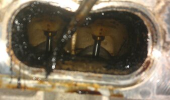

OK well I will check that later since I removed the intake manifold today and am about to remove the valve cover.
Ok well I'm going to reassemble everything tomorrow the intake was full of gummed up oil but under the valve cover it was nice and clean.

KNBlazer said:
How much oil does your truck consume?
None, I recently changed the oil, Took out a little more than 6 quarts but the dipstick was full. It was the same with my brothers 05 tb a little more than 6 quarts so I guess that all of it.
I have used Mopar ccc so maybe that is why the oil is gummed?
Weren't you having a vacuum issue with your PCV system, did you get that fixed yet? Are you able to draw vacuum through the large port on top of the valve cover?
