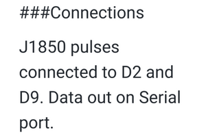

The readme for the code stated to connect to pins D2 & D9 so there I was trying to get anything to work and getting nothing. Eventually looked at the code and it at least looked to me that I should be connected to pins D3 & D9....
Another thing I altered may or may not be correct. I found an instance where the code did not match the comment. I changed the code to match the comment.
I have also tried some other codes/libraries from Github as well as some circuitry to interface between the J1850 bus and the Arduino. I had read somewhere that connecting the Arduino directly to the J1850 bus might not work due to the voltage differences but at least for reading the bus it seems to work with the code you shared. And thus far I have nothing working with the circuitry I have tried. That circuitry was copied from the ELM327 datasheet.
I'll keep tinkering with various approaches. Today I received some optocouplers to try that approach!! Saw them used on an old "Nerdkits" video.

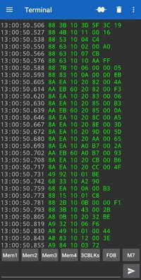

Well I haven't been fiddling with any interface circuitry but I have been noodling about your posted code trying to learn how this all works. I have made some progress here and there. Much is still beyond me and there are things on the horizon that I will struggle with when I need to add them like CRC checking and generation and message arbitration.
I have changed the message monitoring to resolve the full addressing of Primary ID, Secondary ID, and where required for message types 9 & 10, Extended address.
Here is a screenshot showing 3 "load command extended" messages for 'change engine oil' (5th byte 0x82), 'check gauges' (5th byte 0x85), and 'reduced engine power' (5th byte 0xB7) and their respective "status report" messages in response. The first two lights are off and the last light, 'reduced engine power" is on. Currently the reports are still fixed as I cannot yet do the CRC generation.
