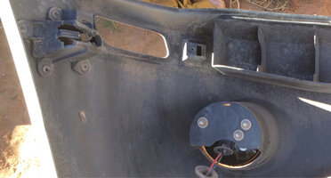

I removed my old bumper, wasn't hard, took about 20mins. So after I took the bumper off I attempted to just place the bumper cover on where the bolt line up. Here is what I have to work with. ImageUploadedByTapatalk1415484354.016634.jpgImageUploadedByTapatalk1415484383.832006.jpgImageUploadedByTapatalk1415484419.063308.jpg
That lower center section looks almost like you've got an intercooler down there. Did everything line up properly?
So there a gap between the head lamps and the bumper cover. About roughly 1/2inch. The the bumper cover sticks out a bit in the sides which can be anchored down by the by bolt on the outer part of the cover, which will need to be modified to add in the brackets that are anchored to the bumper cover.ImageUploadedByTapatalk1415484987.016959.jpgImageUploadedByTapatalk1415485016.403058.jpgImageUploadedByTapatalk1415485130.862842.jpgImageUploadedByTapatalk1415485175.879988.jpg
The only holes that you can place are the top 3 in the center of the bumper, those line up fine, but there will be some work for the side to anchor in the body.
Issues are that the cover seems too low around the headlamps area. Also when I lifted the cover using some small 2x4 blocks. I got a nice looking gap from the headlamps to the cover... But then the middle grille would not fit because the slots are lower then the raised bumper. Also when you lift the cover the bumper cover hits the metal bumper... Where the fog lamps would sit on the cover is where the bumper ends up sitting.ImageUploadedByTapatalk1415485478.574946.jpgImageUploadedByTapatalk1415485510.443789.jpgImageUploadedByTapatalk1415485548.012749.jpgImageUploadedByTapatalk1415485571.064173.jpg
So the first round of looking over everything, I have to get in touch with Paul, maybe see how their mold fit on their envoy. I have 2 body guys that I will be talking to as well. To see what I can do. I don't wanna chop my bumper for this build.... But... Maybe not... I'll keep digging into this. Again this is just from what problem I could run into. I will have to find brackets to anchor the lights and the side cover as well.
