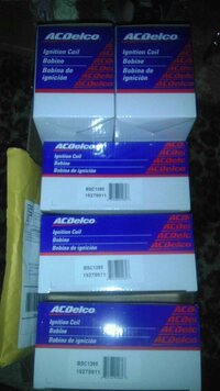

At a stop, truck stalls, fire it up and is jugging, take off and SES starts flashing, at this point already knew bad coil, drove about 1/4 of a mile home....Scanned PCM, and dreaded P0300... unplug one coil at a time, and once I got to #4, no change in idle, whala... checked scanner and indeed P0304...replaced bad coil with my last used spare, and all is well.....the other coils are still factory, 199,335 miles...

But of course I am....lol... current plugs have 10-11k miles on them... will only replace the bad coil spark plug, just received the plugs today, coils yesterday...
