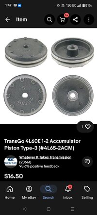

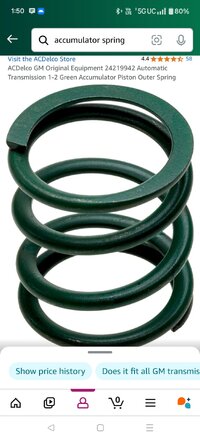

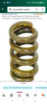

I'm at 225k on my 5.3 Envoy, still the original trans. Mine did pretty much exactly what yours was doing at around 185k (bought when it had 177k). I had the harsh 1 to 2 shift when cold, and the sluggish 3 to 4 shift. Changing the shift solenoids helped a bit, but didn't fix the problem.
What solved the 1-2 shift, was replacing the factory accumulator springs. I bought the original (there's two in the housing, yellow and green), and replaced the worn out plastic accumulator with a metal type- 3 by Transgo from eBay. Installing the Transgo kit is a little tricky, especially if you aren't used to working on valve bodies. I had a buddy at a shop watch me do it, because I was afraid of botching it up lol. Might be easier finding a local trans shop whose willing to do the install for a reasonable price (places near me wanted 80 to 150 for the install).
I would avoid doing a flush on the trans, I feel at the age/mileage it's best not to open that can of worms. The old clutch material circulating may be helping to keep it chugging along, but I wouldn't touch it. It wouldn't hurt to swap out the factory pan for the superior Dorman one that holds an extra quart of fluid, and has the drain plug. Maybe do a drain, and fill every 20k or so. Adding an additional aux trans cooler would hugely help too, since these are sensitive to heat.
I attached the spring part #'s and the accumulator piston below. Also make sure to get the correct valve body separator plate, and get the plastic torlon check balls to replace the factory metal ones.
I have a question for you. Replacing the 1-2 accumulator piston with an aluminum Transgo one will not change the behavior of the tranny from stock correct?
What about the 2-3 and 3-4 accumulators? Don’t we have to change those and the seals on them?
