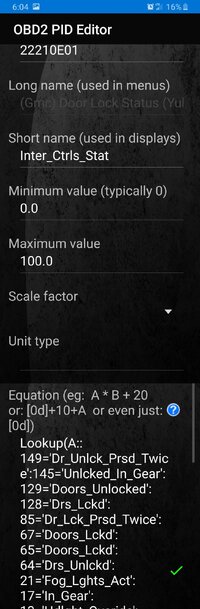

Very interesting indeed. As a return to the information you have shared this is what I've had for some time. I believe this works for my 03 Yukon. One of the reasons I believe this is monitored is for example when you put the vehicle in drive this locks the doors and if the back hatch or any access is open normally you get a warning chime. This also probably works with the "Passenger Presence System" for the airbag system and other systems. This is not something I achieved from another source this was hard earned. Don't know if anyone else has discovered this particular information but figured you would find this useful TJBaker57.

One of my interpretations includes the status "In Gear" which seems to be accurate for this PID. I'll have data stream records to share as well if I can ever get the time. Thank You TJ. Edit: I believe that this PID has been translated to be shared with my 2005 Envoy along with my 2003 Yukon. This along with the aformentioned PID directly relates to the question: "Why would the liftgate module be asking if the engine is running? "
Well I have not seen this elsewhere. What you have here is another PID for the BCM which is a bitmapped representation of the status of the door ajar switches.
bit 0 = drivers door
bit 1 = pass. door
bit 2 = Driver rear door
bit 3 = Pass. rear door
bit 4 plus bit 5 = rear hacth OR glass
The same PID works for the trailblazer however for this vehicle the rear glass and rear hatch are separate, bit 4 being the glass and bit 5 being the hatch.

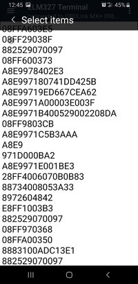

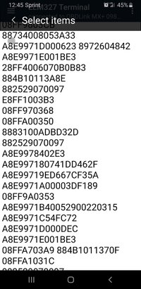

Sounds like you've gained a head start with your knowledge base on this subject. Not so easy for the light minded to follow. So it sounds like everything ultimately goes to external access C7 as the middleman in this case, and from there is communicated directly with BCM on C6? What's amazing to me, is how intricate and complex this information sent around. Quite interesting to me to observe the actual behavior of the data itself. The value in this, which most people do not realize, is learning this system is thus in term learning old Tech, which all new tech is built upon. In a way it's a simple system yet complex. Very intrigued am I. With the information you have shared it will help me with our specific vehicles should I get the time. Wanted to share a raw data log playing with the radio mostly, and see what you think about each byte of data. This was done on my Yukon with the Bose non Lux system, a while back. As for document SAE 2178, I have jotted through all four sections, but never got the chance to really focus on the details, however, I am familiar with much of this information the rest I can only guess. If my memory serves me well, I do believe "header printing" was turned on. I want to say "allow long messages" was enabled. Some of this data may include cycling the power on my rear view mirror. Playing with the mirror was done when it was malfunctioning before I re soldered and repaired it.
So with a bit of editing I was able to use data from your screenshots in the spreadsheet. Your Yukon has a couple of nodes the spreadsheet doesn't have yet as they are not in the Trailblazer. $A6 and $9A at least so the source name might not be correct but the Target name is correct. I see no mirrors here. The black background cells are merely network heartbeat messages, modules confirming they are awake. the 25 29 97 in tan is something to do with the wheels. I haven't figured that one out yet but know it is not a wheel speed. I do not have any navigation in either truck so that's a mystery, maybe coordinates, direction of travel, that sort of thing? The FF 40 06 seen first at spreadsheet row 16 is 3 bytes of bitmapped status in columns M, N & O. The value in M tells me your key is in the run position. (6 is acc, 8 is start, 3 is off and there actually is a position between off and acc, at least confirmed on the trailblazer where that first click before the acc position powers up at least 2 circuits, fuse #50 and #47) I think this is done to give the PCM and BCM a headstart before the ACC position is reached. Moving on, 2 entries to target address (Primary ID pair) $73 & $72 are the BCM reporting the current voltage to the IPC. Your value is $053A which equates to 13.38 VDC. The next new thing seen is at spreadsheet row 23 (leftmost in pic) and this is the PCM reporting a fuel system value. While I cannot pin it down yet I have a hunch it is fuel used to be added to the fuel used variable in the IPC. On longer sessions in my Yukon this value has risen up to the max of $FF then restarts at $00. The only guess I could make is a consumption count of some item and the Primary ID pair is designated as fuel system. The next new item is at spreadsheet row 29 and is the PCM reporting engine oil pressure, Primary ID $4B, Secondary ID of $11 (as seen in SAE 2178 section 4). Your value there is $3A. SAE 2178 sec 2 gives us the scaling of 1 bit=4 kPaG so a little math yields 33.65 PSI. The rest seems repetition of previous lines for the most part.
I would add the command ATS1 to your logging initiation string to keep the bytes separated and far easier to read. What are you using to record?

What drew me this app is:
Supports up to 35 macros such that you can write out your command strings and have them ready to send at the push of a button.
Save your data either straight to clipboard or a timed & dated text file.
Very simple setup, I just set a line delay of 1000 ms, a between character delay of 5 ms, enabled timestamps, pick a directory for log file saving and I may have needed to set the end of line character(s).
My biggest issue in doing any of this is an apparently inherent instability of Android Bluetooth.

I also have an LM7 in my 2005 Yukon. If we are speaking of the [GM] extended PID set that comes with Torque Pro and needs to be imported....some of those will work and some won't. As for Class 2 vs CAN bus the PIDs will not need modification as the ELM327 obd adapter will handle that matter of message formatting. You may have discovered the "More PIDs for Torque" thread here. I have uncovered a raft of PIDs for the 4.2 LL8 that were previously unknown to the public. I seem to remember some for the Yukon LM7 also but would need to check my records.
I may even have some that never got posted! (I'm not the most organized individual)
You are amazing with this stuff and yes I watch that thread too (to say these two threads are great is not even close to blowing enough smoke). My ELM327 should be here on Wednesday of next week and I am really looking forward to “getting good” with it. Any LM7 PIDS help would be greatly appreciated. Can you advise which of the [GM] extended PID set do not work for my LM7 so I can steal clear of those. Are the non-working PIDS not for class 2 or need to be edited to pull the correct information or just do not work for other reasons? Love to learn! Thanks again
