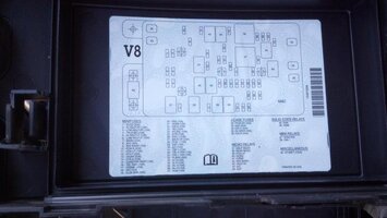

Can I get pics or a schematic of this? I looked and looked for a low beam relay to no avail in my fuse box,

Don said:
I have a 370, and no relay in the front. :(
You should. Take your front fuse block cover, and look on the inside of it. It should give you a layout and assignments for the different relays and fuses. :book:
Edit: #46 Should be labelled "Headlamp Driver Module"
I will get pics tomorrow.

Ok, #46 is the solid state relay. I think I was a bit confused by the pic that it was using the headlight washer relay for some odd reason. I got it done and also cleaned it up a bit when I soldered everything up, Thanks.
