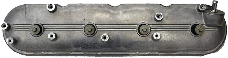

Well, after sitting on a new style updated PCV driver side valve cover (Dorman 264-969) since January and having smoke on start up about every 3rd start, I finally decided to swap it out. (The oil consumption is a given. Hopefully the new cover helps that as well.) Watched a quick Utoob video, and since it seemed pretty darn easy, decided to get right with it. Took 20-25 minutes and only half a beer. Since it was going so quickly, I didn't drink much...
One connector - in the center for the coils, the four plug wires, five 10mm coil bracket hold downs (get the coil assy out first), the four 8mm (5/16") valve cover bolts, and the PCV hose, and she's off.

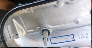

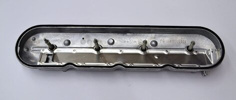

Here's the shiny new one in place.

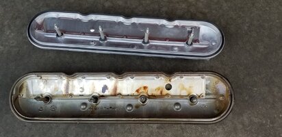

The inside of the old one was FILTHY!! Wow! I change my oil about every 5,500 miles, and I'm topping up with a quart or three between changes.
Wow! Maybe the previous owner didn't religiously change the oil?

Wow! Yours looks pristine inside. I'm guessing at least one of the POs didn't take care of her. She was burning 6 qts between oil changes for my first two changes. I got the Lime-Swap tune and it dropped to 3 immediately and is between one and 3 now. I got it with 139K and I'm at 206K now.
