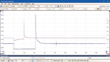

(3) Obtain "Known, Good EFI Wave Forms". Finding out what the correct Wave Forms look like for any particular component in advance of setting up the Equipment on the Vehicle will be the Key to comparing them against what appears on your Laptop Screen during your Tests.
For Example... Here is a CLASSIC Known Good EFI Wave Form that shows a familiar "Bump" in the signal oscillation which proves that after the EFI actuated a spray of fuel, the Pintle Valve successfully closed:
