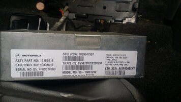

Well, my truck has an amp system right under the rear seats on the passenger side opposite from the secondary fuse block. I thought this is what powers the door speakers because on the driver side the front and rear door speakers have great sound with bass. The passenger speakers not so well but I think they are worn. I figure all I need is to pull the wire from the old speakers and apply them to the new, and use the new power amp for the subs which I believe they are intended for only. Please correct me if I'm wrong about that block that is opposite from secondary fuse block. I bought the truck from a used auto dealer, so I'm not completely sure if I'm right about this.
That's usually where the OnStar module is, if your vehicle is equipped with it. People have been known to ditch OnStar and install other stuff in that location though. Could you snap a pic and share that with us, then we'll be able to give you better info. If you have the Bose system, the amp is usually behind the passenger side cargo panel for SWB trucks, and behind the driver's side cargo panel for LWB trucks.

:yes: That's your OnStar module.
Edit: For a quick check, glance inside the speaker grilles on your dash. If there are tweeters in there, you have the Bose system, if they are empty, then you don't.

Sorry guys,
Had to take my mother to the doctors today. So in the clips is the unit, it is located under the rear passenger seat. It's not a Bose, I have a short wheel base truck. And Moose is correct, I only bought the extra amp for the subs that will be fitted in the back space behind the rear seats. The regular speakers will go on the doors where there are already OE wire installments that I will just remove from the old speakers and put on the new ones. I'll send you the info on them next. I'm not trying go competitive with the upgrade, just better sound than the OE system.
Oh yes they are definitely empty. Wish I did have a Bose. Okay so that's the OnStar. Well, this is beginning to sound more complicated. I was trying to avoid spending extra bucks on having a pro do the upgrade because I've done stereo hookups for home theater syatems, figured this would not be far from the same concept.
That's where (assuming you have a paid subscription an active service) you can push the button on your rear view mirror and have them call you a tow truck, similar to AAA. Also if your check engine light is on, they can read the code remotely and tell you what it is. If you happen to lock your keys in the truck, you can call them and they can send an unlock signal. In the event the vehicle gets stolen, they can slow down the engine if it's running, or block the ignition from firing.
This shouldn't get in the way of your system install, you just have to find another place for your amp. If you aren't using OnStar, and don't plan to, you can disconnect the module, and put your amp there instead. Others have done that in the past.
