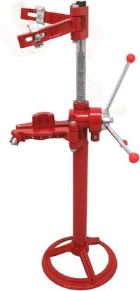

Without knowing whether the Saab 97x 5.3i has the identical rear suspension as the Saab 9.5... This video showed some promise with Mechanically raising the rear suspension lift using Secondary 3/4" Spacers made of 1.5" Galvanized Pipe.
Mind you... this idea involves having to Compress and Remove the Rear Struts' Coil Spring Retaining Nuts and this involves no small amount of DANGER to the Mechanic if extreme care is not used in the doing of this non-trivial adaptation.
If this ides looks promising... there are quite a few Threads with Member suggestions worth reading...and with optional, more updated methods available now for Coil Spring Compression that will reduce the possibility of Injury...or Death.
