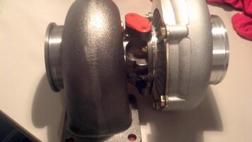

THE TURBO IS IN !
godspeed Gt45 cloned intake/exhaust housing (VERY STRONG) but internals are not, so I gutted internals/wheels
had Garrett GT45R internals (comp and turbine wheels) installed and the whole setup balanced
SPECS:
Intake: 4 inch
Outlet: 2.5 inch
Compressor trim: .70 ar
Compressor Wheel diameter: 66.71 /84.20
Turbine wheel diameter : 63.56 /73.60
Exhaust trim: 1.00 ar !
Turbine flange type: t4 flange
Downpipe flange type: 3.25" v band flange
oil cooled only*
Horsepower rating: 400-600hp+
Capable of 38 PSI I will only run about 7 psi / 8psi max to play it safe.
