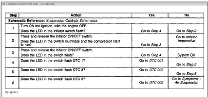

Try this. Apparently the Compressor will flash - that is the diagnostic code - if something is wrong. You will need someone to start the vehicle for you. Check out the pics.

Get in the back and watch the led on the manual inflator switch. Have someone start the vehicle. The number of flashes on the LED (1,2, or 3) is an error code that helps you diagnose the electronic suspension. Even if the compressor doesn't kick in, the LED should flash.
The led comes on steady and compressor kicks on. Screwed the inflator hose on the male Schrader valve but no air pressure and not enough to push the needle out at the opposite end. Looks like the valve for the inflator isn't even opening on the inflator. My mechanic literally gave up. Matched every wire and hose connection to my old system. Could be a bad compressor. Been buying parts from Rockauto for 10 years. Never a wrong or bad part in nearly 75 orders.
