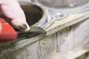

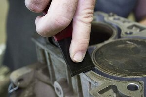

An Honorable Mention is in order back to @Mounce for introducing us a while ago to the Lisle Carbide Scraper Tool Set essential for this kind of Work:
